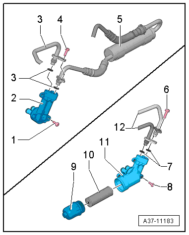

    Quote Originally Posted by whiped View Post
    Filters:
    There are 2 different ATF filter versions depending on the engine and the date of manufacture.
    Inline filter(5) & Exchangable filter(10):
    Is there any way to know which filter you have before starting the project? i.e. prior to 2011 it was inline and after that #10? Seems like most everyone so far has had the exchangeable filter.
    Sold: 2014 S4 | EPL Stage 2 + TCU | ECS Intake | CR15 | 034Motorsport RSB | ECS Trans/Diff Inserts | Mr. Spectacular's 10" Subwoofer Box w/10w6
  4. #84
    Veteran Member Four Rings theweebabyseamus's Avatar
    May 12 2008
    28667
    Quote Originally Posted by minman26 View Post
    A dealer should be able to tell you off your VIN. Good luck on being the in-line filter. Lol

    Here are the parts and parts numbers for my dsg (2013 S4) external cooler filter and o-ring gasket fyi
    Sent from my LG-US996 using Tapatalk
  27. #107
    Jan 22 2017
    391291
    Acura MDX, 4Runner, FJR1300, Mastercraft, 89 Bronco 408w
    Wisconsin
    So I completed this with the transmission fluid change kit from Blau parts. It included Ravenol fluid... All went well. Does anyone realize that audi simply installed an oil absorbent mat under the tranny rather than fix any oil leak issues...?
    Anyway I thought I might help clear up the debate about whether the internal filter is a filter or a strainer. I cut my old one apart... Definately a filter and not just a strainer

    I just did mine, 2010 and it did not have the small cooling filter cartridge. I used about 6.5 liters of fluid as well.
    One thing I will add is that when installing the internal filter for the DSG, it should wiggle it's way in and stop once it's inserted far enough so that no more of the orange rubber is showing. On the top side of the filter you will see a plus symbol that is raised, this lines up in a cylinder hole on the inside of the casing. It acts as a guide to ensure the filter is seated in the correct position.
    Thanks for the write up mate!!@
    slave of corruption
    O-ring part number WHT003379 goes over the + on the top of the cartridge. I don't think I saw it mentioned anywhere else. Used this sticky today and it made life way easier!
    EPL DP 93 & TCU//EPL SC Pulley//KI 181 Crank Pulley//PLM HE//034 Trans Mount & Insert//034 Read Diff + Subframe Inserts//CTS Intake//ECS X-Pipe//Autotech HPFP

    Mar 05 2016
    369795
    Attachment 88357
    Does anyone know where that O-ring goes?
  39. #119
    Feb 17 2012
    88374
    Cleveland/OH
    If I remember correctly it goes on the top of that white cooling filter
  40. #120
    Feb 17 2012
    88374
    Cleveland/OH
    Actually take that back, that looks like the small one that goes on the plus symbol of the black filter. That stupid filter does not stay in place, but just line it up so when you put pan back on it goes into place. I actually had a buddy use a thin plastic scraper to hold it in place while lifting pan up. Scraper was thin enough to get pan close enough to hold it place.Screenshot_20181010-234928.jpeg
