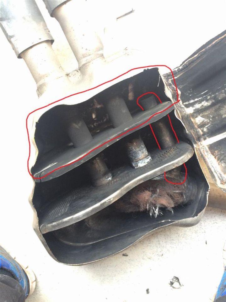

    To the OP -
    That's exactly what I have just done, replaced rear silencers (mufflers) with some custom fabricated ones, made locally by an exhaust fabrication company.
    I used Jaguar XK8 tips 90mm dia.
    I ended up with a nasty drone at 1900 - 2400 RPM, otherwise fine.
    When I cut open the OE Silencers, I found out why.
    OE have a Helmholtz RESONATOR built in. See attached photo.
    The tube highlighted runs from the inlet of the silencer to a closed chamber.
    I got round this by adding a pair of 1/4 wave resonators (J - Pipes) 34" long.
