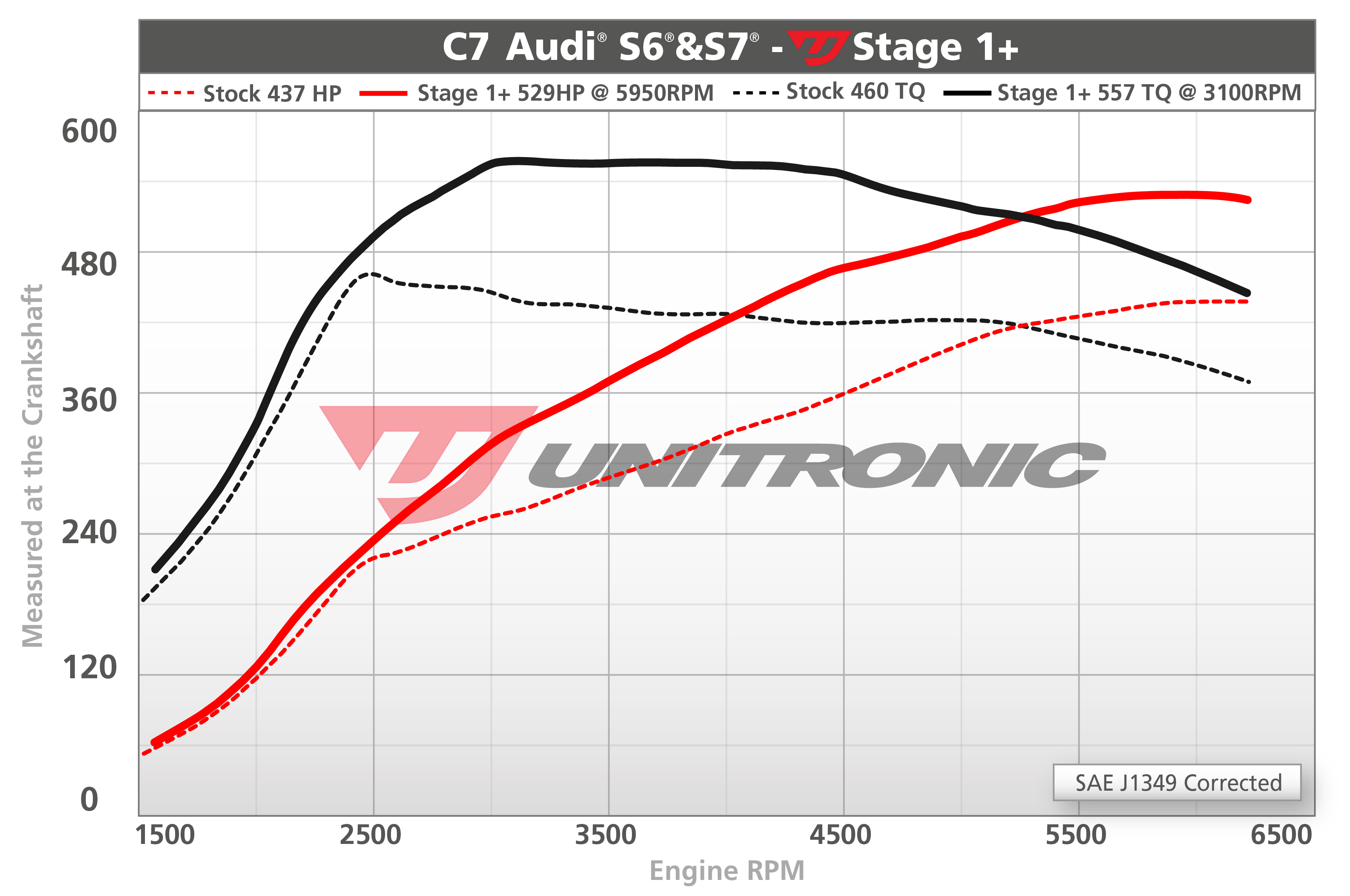

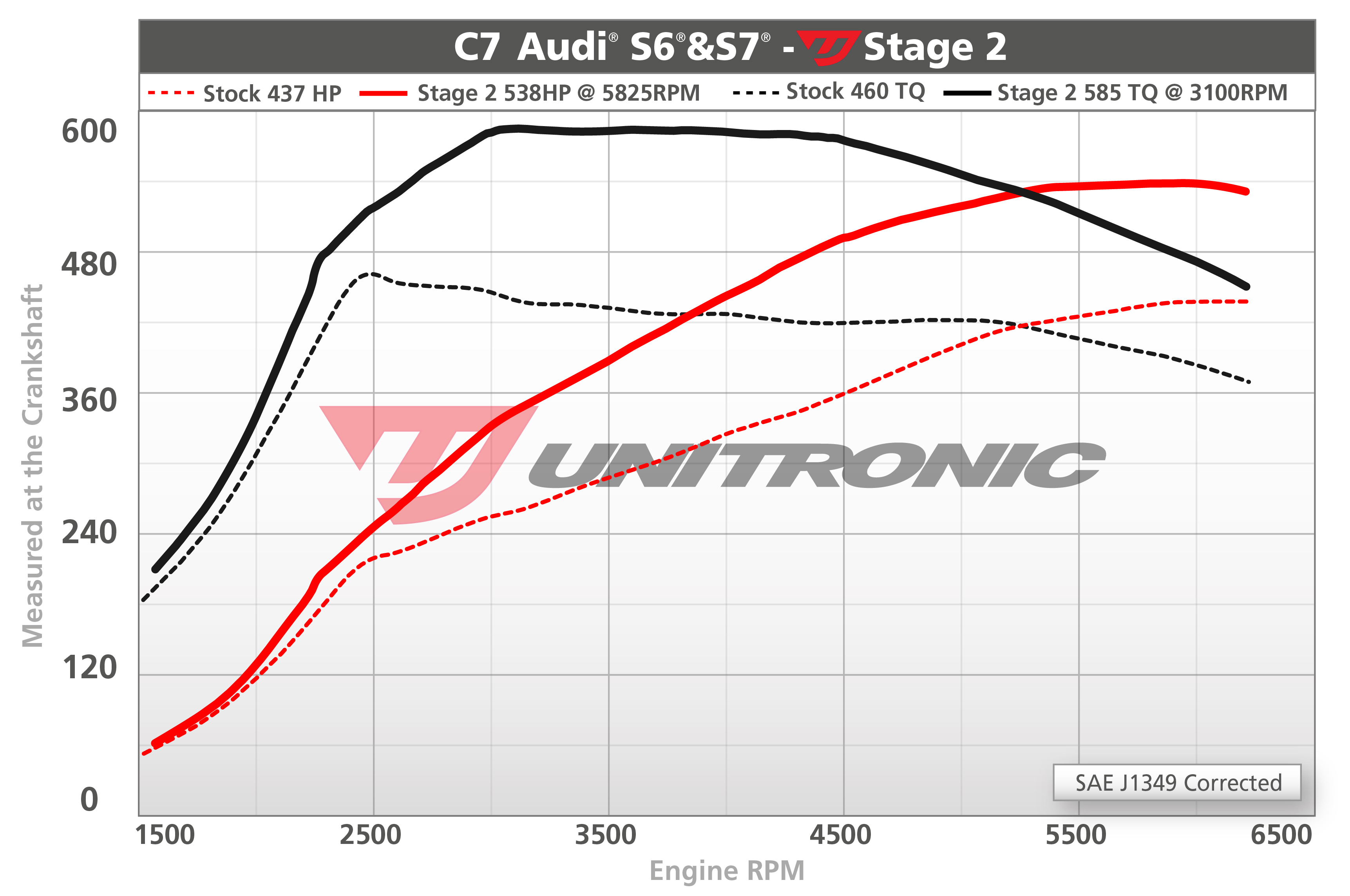

    These are arguments which could very well be true if the stock S6 downpipes were deemed a restriction at the levels we're seeing. Based on everything I've seen though, I believe they flow plenty at the power levels we're all at right now. So turbine inlet pressures, exhaust gas temperatures, etc are more than adequate with the stock downpipes as they are with aftermarket downpipes, thus no power gains. Install gigantic turbos on your car, crank up the boost to 35-40 PSI and then I'd probably agree with the statements below since the downpipes (and catalysts) would likely become a restriction at those power and boost levels.
    I think a common misconception on the forums is believing a hardware component is restrictive just because it's the stock OEM piece. People often believe aftermarket parts have to be better than stock and add power just because you're getting rid of the stock part. Sometimes it's true, sometimes it's not. Sometimes the aftermarket part actually loses power! For example, aftermarket catbacks for the 4.0T as well as a name brand cone style intake were both shown to lose power on APR's in house dyno. Bottom line is every case is different. In this application, the factory downpipes flow very well. They flow so well that Audi's performance division "quattro GmbH" didn't bother changing them for the much higher horsepower RS6/7 variants, despite the engines running bigger turbos and more boost. Tuned RS7s have gone as quick as low 10's with the OEM downpipes (same as S6 pipes). A tuned RS7 makes a solid 100-150 more HP than a tuned S6/7...
    For Saxon, I'm just curious, what made you decide to go with the Unitronic stage 2 setup? Their own dyno sheet below shows minimal gains over stage 1+... The same kind of standard deviation you typically see from just one dyno pull to the next. In other words, the results were so small they're hardly even quantifiable.
    Stage 1+: 529 HP (peak): https://www.getunitronic.com/imgs/dy...i-S6-S7-C7.jpg
    Stage 2: 538 HP (peak): https://www.getunitronic.com/imgs/dy...i-S6-S7-C7.jpg
    So a 9 HP gain (peak) with aftermarket downpipes and aftermarket catback. 9 HP in a 4400lb tank is probably not going to show up until the last decimal place on your timeslip.

    If all you care about is peak power I'd agree, however the mid range gains are pretty significant

    Maybe 10-15 in the mid range? That's for the downpipes and catback, not downpipes alone. Could also be differences between the stage 1+ and stage 2 software that account for some of that gain.
