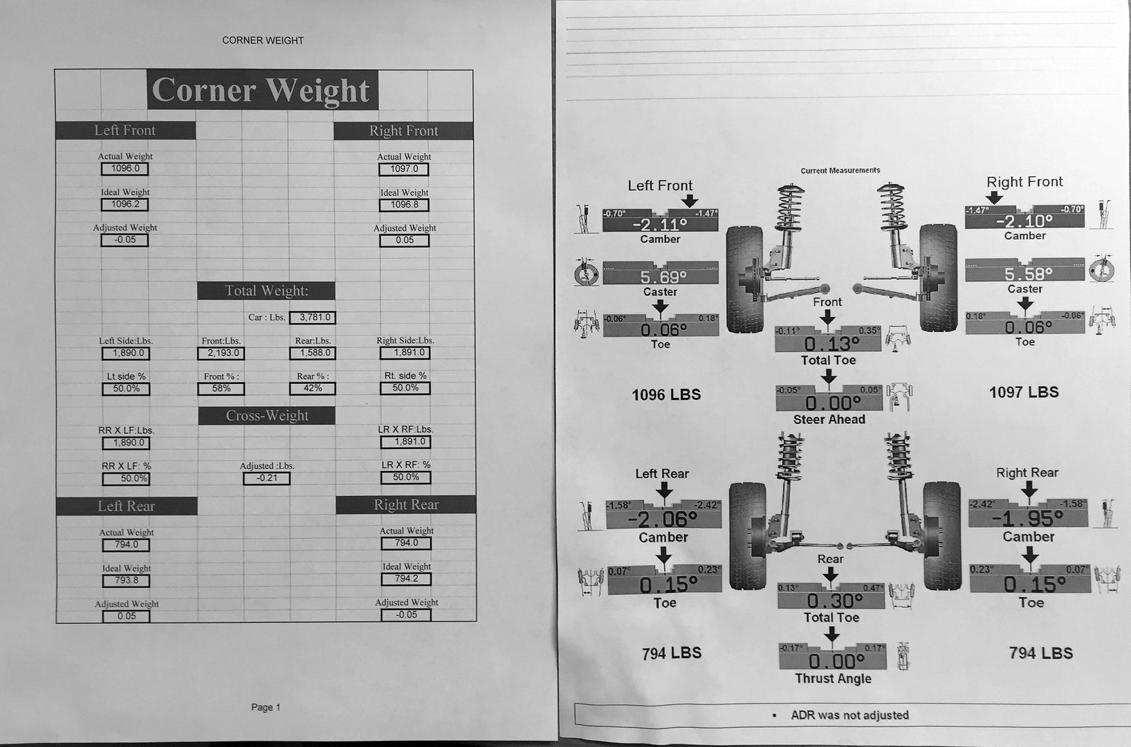

    Mine is down to 3,781 lbs with a little under a half tank. No spare, no rear seats. Could be worse I suppose. Im loaded up DSG prestige model so starting out with highest curb weight.

    Quote Originally Posted by firstars View Post
    Thanks, that's a lot of good info there. I was wondering about the balance front-to-back. That gives me some info to run numbers on
    Can you lay out the items that you have removed or switched out that would have a weight impact?

    Quote Originally Posted by Victor Newman View Post
    Remove rear seat and seatback (over 70lbs), Vorsteiner VFF 106 19x9.5 et35 (under 21 lbs), RE71R tires, Brembo Club Racing 355 BBK (I have weight somewhere), H&R RSS+ coilovers (definitely lighter than OEM ADS shocks), no spare, no rubber mats, no tool kit, milltek exhaust (didnt weight but might actually be more than OEM since its valved)
    So stock battery, right?
    Since I haven't weighed my car that specifically, I'm going to be playing around with your weight balance numbers to see what adding weight back to the trunk (spare / jack) or replacing the stock battery with a lightweight battery would do to the static weight at the wheels, and by how much the CG would move forward. I want to compare that to front / rear weight balance and total weight on the front axle versus rear axle. There are definitely more "ideal" places to remove weight - like the front end of our cars, but I'd like to know whether removing weight in the rear would have any negative effect. I don't think so, but would be good to get some objectivity behind it.
    After removing my spare and jack, I felt like turn-in was better due to not having to accelerate that weight in the tail. The front felt the same - still heavy steering, but at least the rear wasn't pulling to the outside too.

    A couple of quick rough numbers.
    Rear axle to center of battery and spare tire is 20". Say you removed 100 lb. from that point between the spare, battery, jack, tools, etc. (100 lb. just as an example). The static load is 100 lb. on the 20" cantilever generates 118 lb. on the rear axle with an uplift of 18 lb. on the front axle.
    So by removing the 100 lb.:
    1) you're removing 100 lb. from the total weight, and decreasing moment of inertia (CG moves forward by a very small margin)
    2) rear axle weight decreases by 118 lb.
    3) front axle weight increases by 18 lb.
    If firstars removed an additional 50 lb. from the rear, it would end up being:
    Front axle weight: 2202 lb.
    Rear axle weight: 1529 lb.
    Distribution: 59% / 41%
    Total weight lost: 1.3%
    ...........i think
    And wouldn't that reduce understeer? If the front tires see more weight, but the actual mass at the front doesn't change, you don't have to accelerate it laterally at the front end. So basically, you've got more front end traction, but with the same mass to accelerate laterally.
    And while the rear tires have less weight on them, they would lose grip sooner, but again, you don't have that rear mass to accelerate laterally, either. Moment of inertia decreases, and the car is lighter overall for braking and acceleration. But i could be wrong.

    by removing 100 lb from the point where the center of the spare sits, moment of inertia is reduced by about 4,750 lb ft^2 for whatever that is worth, relatively.
    so it looks like there is an advantage in multiple areas to removing weight out of the rear. reducing that rear mass should allow the sport diff to rotate it easier as well
    How did you obtain that number for the moment of inertia? there should be various moments depending on distances over which they will be 'rotating' about, ie: roll axis, cg, etc...

    Quote Originally Posted by jachien View Post
    just static from the center of gravity
    inertia is just the point mass multiplied by the squared distance from the CG - it shouldn't change. The tires are exerting external forces on the car, which will change, but inertia of the vehicle itself should stay the same I would think
    Are you on coils or springs only? Wondering if -2 negative camber F/R and L/R correct post alignment?
    16 B8.5: S4 | Premium Plus | Ibis White | PNY | PPS | GH2 | 1BL | Black Nappa | CTS
