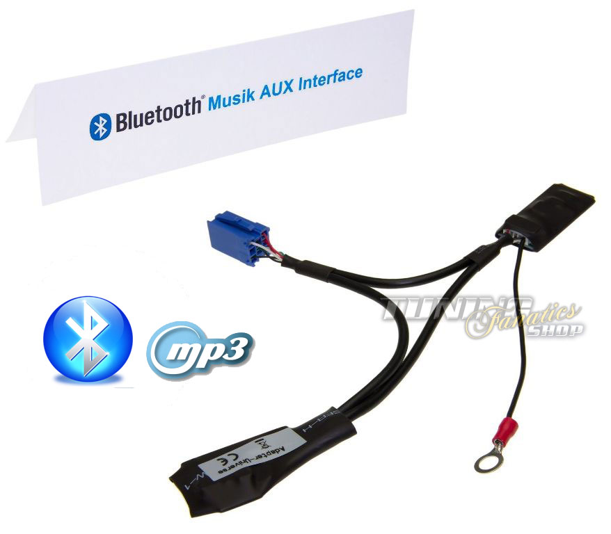

    Little bit off topic since it's not a specific Ipod adapter...but Check out this little thing I stumbled across:
    S2 Bluetooth adapter
    The description isn't very good, but says what it does well enough. For the price and ease of installation it's fairly tempting. Seems like it would be easy enough to re-pin/ adapt to an S2+ head unit.
    I've bought other stuff from those guys and everything else is exactly as they describe it..

    For anyone searching in the future for an AUX in option that won't break the bank - consider this one for ~$20:
    https://www.amazon.com/gp/product/B0...?ie=UTF8&psc=1
    I can confirm it works as advertised with a Symphony radio. In fact, I'm quite impressed with the sound quality. GL.
