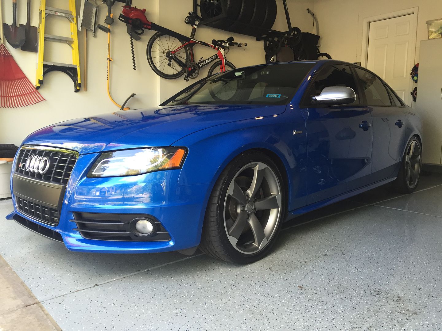

  25. #65
    Veteran Member Four Rings Vogz's Avatar
    Jul 17 2010
    61526
    996 Turbo
    Batavia, IL
    Quote Originally Posted by AC419 View Post
    ^^ Caymanite, is that with the B12 kit?
    What is everyone's wheel gaps after this drop?
    I haven't measured but here's my car.
    Almost identical drop to the H&R OE springs I had previously.

  26. #66
    Senior Member Three Rings AC419's Avatar
    Nov 23 2012
    104619
    So Cal
    Thanks Vogz. It seems lower than 1.2" rated. Pretty nice!
    Jul 17 2010
    61526
    996 Turbo
    Batavia, IL
    No problem. I had the H&R OE before and didn't measure the difference from OEM but the Eibachs look to be about the same drop. 1 finger gap in the rear and slightly more in the front.

    Quote Originally Posted by SteveYem View Post
    If I want the firm yet comfortable, bump-absorbing performance of the Bilstein B12 kit (I have no first hand experience, just judging from what I have read here), but I want to have ride height adjustability so that I can go a bit lower than the B12 kit allows, what is my best option? Bilstein PSS10 coilovers? KW H.A.S. matched with some aftermarket dampers (if so, which dampers?) Other options?
    I have been on H&R Street Performance coilovers for about 2 years and I'm ready for a change.
    KW H.A.S. with Bilstein B8 dampers is my vote. The dampers account for 90% of the ride quality and the B8s are perfect for a street car IMO.

    My front dropped about an inch and my rear a little less than an inch. I spoke to Bilstein regarding the 30 to 35mm drop on the web and he said that is the typical drop range for all models the kit fits so it's somewhat misleading as this kit also fits the A4. I am hoping my rear drops a little more as VOGZ's rear looks lower than mine. I am also going to check the springs to make sure the installer seated them properly.

    After my springs settled they are virtually the same height. 26" ftg front and rear.
