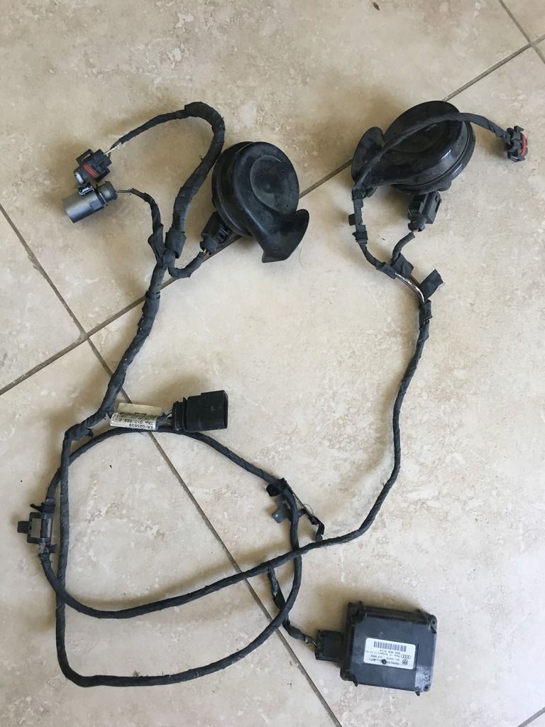

    Here is the horn with wiring... Maybe it does include the plug for the fog lights. Forgot that I currently dont have the fogs in.

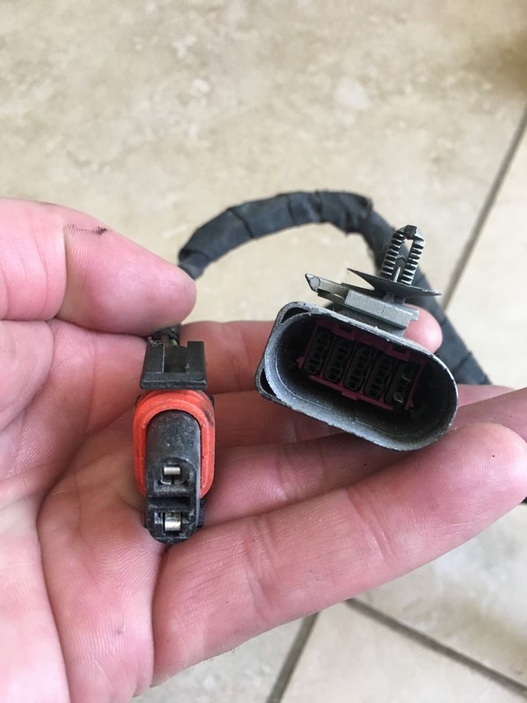

    Perfect! Okay is that connector you got there shown, is with the plastic screw tab, is that the only connector with that screw? If so thats exactly the one i had a feeling would be it. But i still never got a 12v readout when i tried the connection from pushing horn while reading

    Yep.. But there is two of them.

    And the horns are typically put together right? Like in a stacked assembly almost, or is it a left side ride side kinda deal

    Pretty sure there is one at each side.. If I remember correct it mounts off the crash bar.
