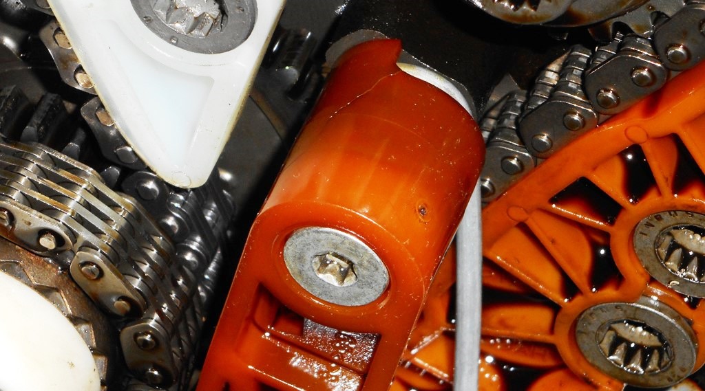

  7. #927
    Jun 27 2011
    77478
    From my 2012 2.0t q5, found this during an oil change today sitting in the drain pan, it definitely came out of the oil pan:
    Chain tensioner?! Ugh...
    -CP
    Pop the inspection plug and take a look before you start it again!

    I have no idea what that's from. Whatever it is, it almost looks fibrous rather than metallic. Can't tell. But....I might take Novarider's advice and look in the inspection hole.

    The problem is that if its a piece of cracked guide your tensioner could still look fine. What is that splinter piece made of can you tell?

    It’s orange-ish plastic, sorry I couldn’t get close enough with my phone camera to make that clear. If it were my b6 or b7 I would have just assumed it was plastic that broke off the dipstick, dipstick tube, or cam chain tensioner but since the q5 doesn’t have a dipstick but does have an assload of chain tensioners and guides...
    Where is the inspection cover? Engine code is CAEB and I’m an ea888 newb...

    Part of a chain guide maybe?
    Hmmmm....about the color of this soon-to-fail oil chain tensioner I found when I did mine?

    386232
    Judging by the color, yeh it does look like part of a guide.

    Quote Originally Posted by wkhanna View Post
    what was your mileage when you did your R&R?
    85,000 miles. As you can see, brand new guide just about it. I was about to put the new cover over it all and took one last look. Had to stop everything and run to the dealer for a new oil guide.
    Well at least you can think of this as kind of a good thing. You got a warning that stuff is starting to break down in there. If your guides are cracking you might as well do the chains and tension or as well. Some people don't get a warning so there's that
