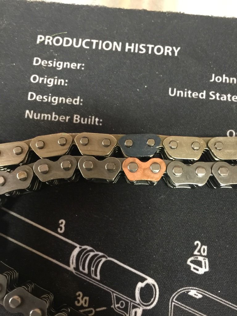

    I will take some measurements of the chain lengths and the wear on the guides as well. I really want to look at the tensioner as well.

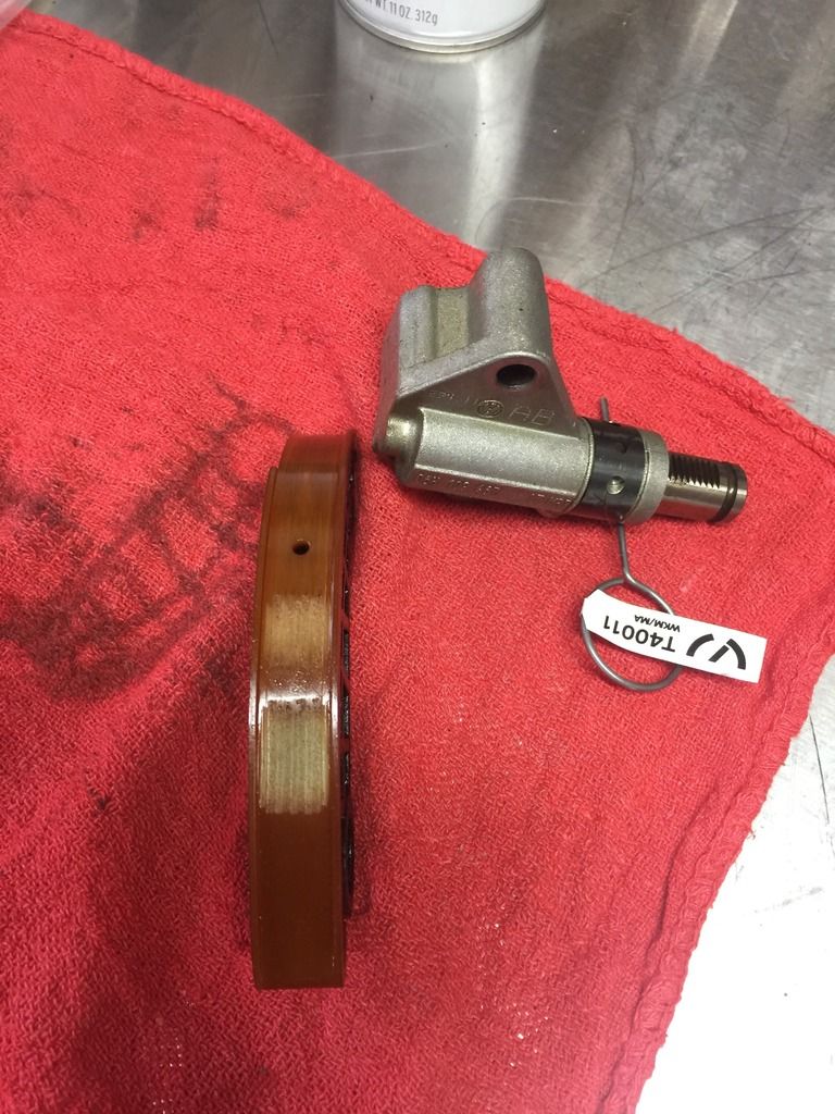

    I'm trying to figure out a DIY to replace only the tensioner (2011 2.0T with 80k miles).
    From the DIY thread, it says to remove all these components. But in this DIY, the guy is replacing more components like the chain, guide rails, etc.
    I am looking to simplify and do it myself, only replace the tensioner. Can someone please help me determine which parts I have to remove to get to just the tensioner? I have heard it can be a pretty simple DIY and I've worked on this car enough to know my way around.
    Thanks for any help!
    Remove front bumper
    Remove rubber air dams
    Remove crash bar and head lights
    Remove crash bar supports (16mm bolts)
    Remove Intercooler
    Swing AC Condenser aside
    Drain coolant by twisting valve many turns.
    Unhook tranny oil line ( if so equipped)
    Unplug fans and remove rad.
    Unscrew lower rack carrier braces
    Remove lock carrier (rad support)
    If you don't feel comfortable getting to this point, perhaps this shouldn't be attempted.
    Next is the engine:
    Unhook turbo coolant hose and swing aside.
    Remove serpentine belt, tensioner and idler.
    Remove crank pulley and install T10368 spacer.
    Remove cam actuator.
    Remove exh cam bolt.
    Remove LH THREAD valve with T10352/1
    Set cover aside.
    Remove lower cover (try not to destroy it! It's on there solid!)
    Remove oil pump tensioner and unhook chain.
    Remove upper chain guide rails.
    Remove chain and shit yourself when intake cam slams forward!
    Remove old tenisoner and top guide.

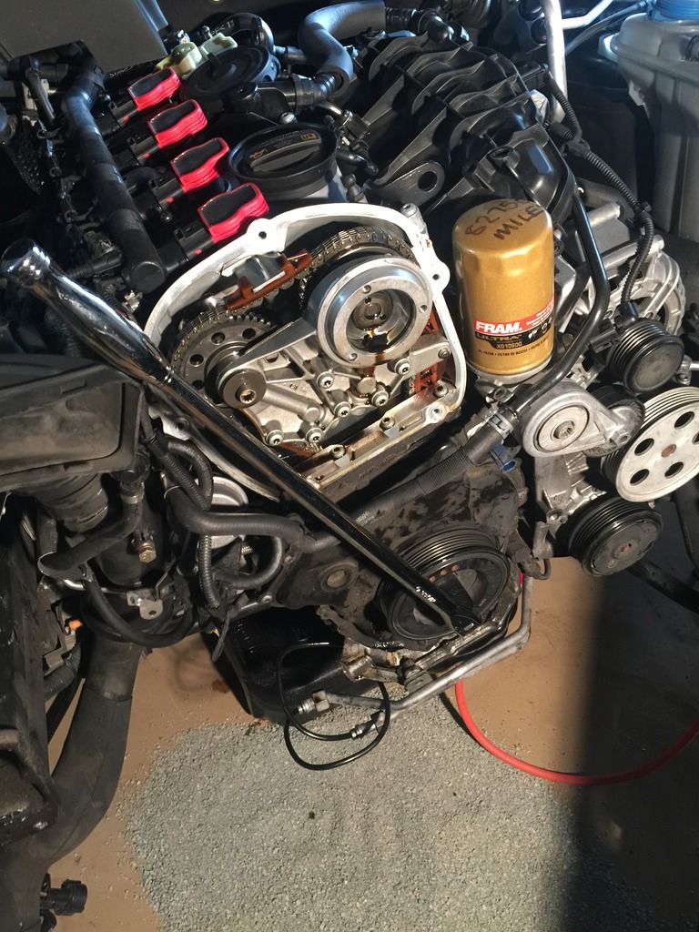

    Going to order the following from ECS Tuning to fix mine in a week:
    Ultimate Timing Chain Kit
    Brand: Genuine Volkswagen Audi
    ES#: 2592689
    Mfg#: 06K109158AKT2
    Timing Service Tool Set
    Brand: Schwaben
    ES#: 3145737
    Mfg#: 020946SCH01A

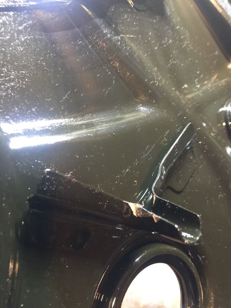

    Finished mine up yesterday, and found only one guide worn severely, but the tensioner was almost at full extension. 84,677 miles.
    Back of the cover was starting to get chewed up:
    Old chain top and new chain bottom:
    Lower crank guide was the only real worn piece:

    Could anyone tell which tensioner this is?
  34. #394
    Veteran Member Four Rings audrobotic's Avatar
    Jun 30 2014
    260490
    West
    That's an old (bad) version. That black band comes loose and wreaks the havoc.
    You can find several youtube videos about the differences - here's one: https://m.youtube.com/watch?v=G82iA4n3LBM

    Quote Originally Posted by audrobotic View Post
    The messed up part about this is when the car was in to replace the pistons and rings 10k ago I told the SA to replace the tensioner if it wasn't the latest revision. When I picked up the car and I asked about it he said all my other parts were in perfect condition.
