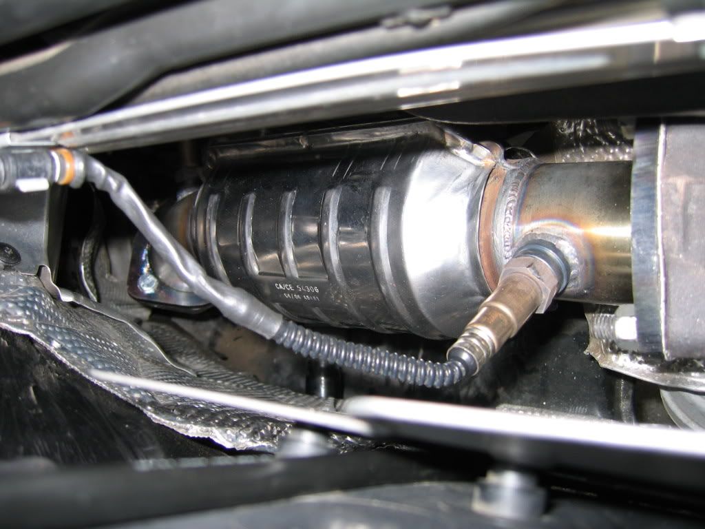

    It is, and an aftermarket HFC will help with escaping gas and temps right after the turbo, but it'll still just bottle-neck at the OEM exhaust. That's why people with aftermarket exhaust already installed, then install a TP or HFC, notice a bit more difference.
    If you're not going to go TP (which I wouldn't recommend - emissions pollution), then look at Milltek HFC or MTM DP/Relocated CAT. I'd do the whole MTM exhaust IMHO (76mm --> 70mm turboback w/ HJS 100 cell CAT). Milltek uses HJS CAT also, but I think it's a 200 cpsi for our app. I'm pretty certain OE CAT is 400 cpsi. Also, HJS has a higher standard, better metalurgy application process for their CAT's (quality/quantity of precious metals used..etc), so even though it is 100/200 cpsi, it works better then expected. It is said that there should be no problem passing CA smog/emissions tests (although I've never been able to confirm that myself, nor the "No CEL" with the MTM DP/CAT).

    lots of info here...
    does having a test pipe make the car sound.... ricey?
    cuz i'm not tree hugger but 800+ for relocated high flow cat is kind of pricey just to save the world when these gas guzzling SUVs are on the road

    update with correct info
    just wanted to make sure I wasn't spreading false info. I talked again with the guys at Stratmosphere. My bad...the B5 HFC will NOT fail if installed on the B6, but often causes CEL's. They redesigned the B6 HFC, still 200 cell, still made by HJS, but it should not throw a CEL.
    just out of curiousity...
    how come they only show one version on their website for the HFC then?

    I had the Tantrumwerks HFC a while back, but decided to sell it because it threw a CEL.. It was a truly nice piece, built very well but it wasnt that much different than the stock cat as far as dia goes..

    Re: Re: update with correct info
    no problem...apparently they just received the new HFC so that's probably why it's not on their web site yet. They had to look around to make sure they had actually received it, so it's quite new...

    well i actually asked Stratmosphere and here's Bob's answer:
    There is in fact a different cat for the B6 A4. Our stock number is MSAU279. The B5 A4 is a MSAU241. They are different ! You will have no CEL's. If you wish to order online, please make a note of the B6 A4, or mention MSAU279.
    We have these in stock.
    once i get my addy in SF i'm gonna order myself one...
