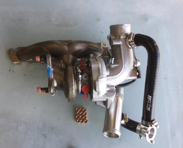

    Quote Originally Posted by A4 Centaur View Post
    Connecting the coolant lines from beneath the car. PITA.
    Yea, those banjo bolts were a pain getting threaded. My exhaust bolts/studs weren’t a problem. I had only 30k miles on the odometer so things were not too frozen on.
    btw, I bought my CTS K04 (and HFC) from a forum member here in the classified section. He bought it brand new but wrecked his car before installing the turbo. I got it still in the original box for $1500. My tune was just a $50 upgrade since I already had their Stage 2.
    Here it is before installation:
    CPMA / CTS K04-0064 / IE custom tune / Wagner FMIC / Custom ZF8 TCU tune

    Quote Originally Posted by Perry01 View Post
    It’s GLORIOUS!
