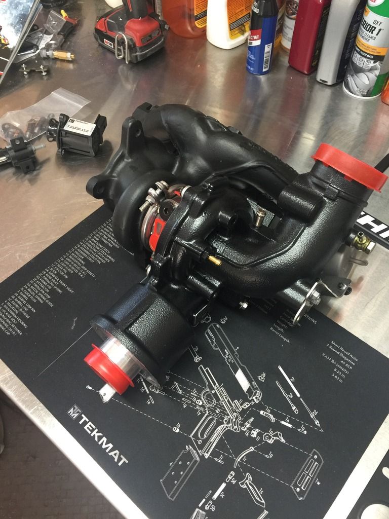

    Looks great! I'll be getting the ECS piping kit since my mod bug runs deep. The piping kit should work fine since the APR FMIC is meant to be used with stock sized piping. What I'm concerned about is the ECS pipes come with an OEM turbo muffler delete which also ups the piping size, but with the K04 there's no need for the muffler delete, so how does THAT connection work. What's everyone doing? Just a silicone adapter?
    2013 Allroad - 12.18s 1/4 mile
    In for this answer as well.
    I assume it's just going to be another coupler but interested in other creative ideas.
    Yep, I just put my K04 in and had to get the adapter to go from the small 1.75" K04 outlet to my 2.5" Eurocode hard pipe. I posted the link to the part in my build thread second from the last page if you have the same sizing. If not you can choose the size you want and it's a good quality product for a good price.
    Edit: I did cut the top part down a quarter inch to keep the pipe from being pushed down into the bar below.

    The KO4-R comes with the outlet on the turbo that is the same size as the OEM K03 outlet. No pipes needed.
    I have the APR FMIC and I am using all the stock hoses, except for the sound delete pipe which is metal.

    Quote Originally Posted by The Infiltrator View Post
    http://www.audizine.com/forum/showth...1#post12366480
    Awesome, thank you! Link for the lazy. Even comes in red because racecar.
    Right, which would be fine if I were sticking with OEM hoses, but wanting larger aftermarket hard pipes adds an extra wrinkle to this adventure.

    Yea, you are right. I used to double up clamps after blowing hoses almost weekly on my A4 Jetta TDI.
    I had huge pipes and varying sizes of both hard pipes and connectors.
    Hi, can you give us some feedback and mayb dyno numbers after you install the k04R from JHM? I'm looking to go the same route as the APR kit is kinda pricy

    Who has some feedback for the JHM K04-R? I know there are at least 3 guys running it now
    I'm running JHM HFC and JHM K04-R with UM K04 tune, have not dyno the car yet, but from my experience I don't think this set up can past the 300whp mark, somewhat disappointed.
    2014 A4 Tiptronic, IE Intercooler, UnitedMotorsport, JHM HFC, STOCK Intake, AWE Tuning A4 Touring Edition Exhaust - Quad Tip. Sportline 7S Gunmetal 19x9.5 ET40, EuroCode Alu Kreuz, 034 Rear Sway Bar/End Links.

    Most of the k04 setups are going to top out at that 300-320 range. My loba lo400 was at 360wheel but it was at it very max output on 28-30psi

    Quote Originally Posted by bhuynh1804 View Post
    Butt dyno disappointment?
    That makes me sad to hear
    Possibly disappointed because of the UM tune? I think the general consensus is that the APR K04 tune is the strongest.
    I don't think too many people on here run UM.
    Foe example with Unitronic, we know that tune has much less (clutch protecting) torque.
    That sucks I had high hopes for this k04 I guess I'll just have to save up more for the cts one. Since you live in so cal did you get your UM tune with James at 4 seasons?

    In all honesty, I think it was me, I wanted something a lot faster, the tune and the hardware are in no mean under-performance, I think i might have to try different route in the future. As for now, I'm going to dyno it first. So that i have a set numbers to base on.
    It's also pretty warm out in CA the past week (at least for us) as we have had nothing but triple digits and today is going to be about 110F. Heat is a real power killer.
    I don't have any experience with UM and their software. I know the APR Software performs very well with the K04 variant turbo.

    This turbo is only $1695 now on the JHM website. I could swear that last time I looked it was $1750.
    I am about to splurge . Really would like to see dyno result of this turbo on the APR software!
    Quote Originally Posted by A4 Centaur View Post
