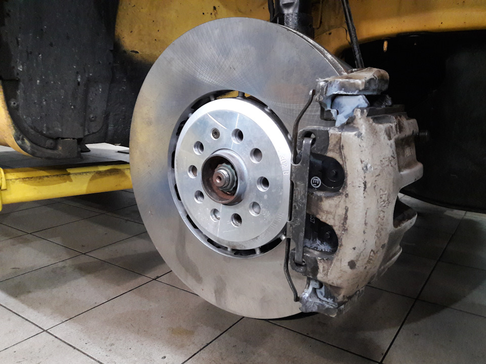

    Veteran Member Four Rings Blazius's Avatar
    Mar 15 2018
    415568
    Europe
    Recently found that there is another BBK path. WILL bolt on without upright swap apparently confirmed by one user:
    I can't post in this thread, but those calipers are straight bolt on to the older strut. They can be found on mk1 TT v6 and Golf 4 r32. Calipers are the same as b5 rs4 and some mercedeses and bmw's, carriers have to come from golf or tt to bolt up. Like you said, bigger wheels are needed. it's 19 cm or 7,48 inches from the middle of the cv shaft to the furthest point of the carrier.
    I haven't actually run them on my car as i have 16 inch wheels, but i have tried them on. I have B6 s4 front discs for them which need to be turned down about 2 mm in radius to fit. And then you also need 1 or 2 mm spacers between the carrier and the strut.
    The only negative is that they are super heavy as they are made of steel not some aluminum compound.
    3.2 L Audi TT brakes from 2003-2006 ish
    334x32 mm rotors.
    2 piston caliper - 41mm ish piston dia.
    2640.5 mm2 piston surface area
    It has short mounting hole distance (94mm for B5 steel spindles) which means it should bolt straight to steel B5 spindles but its unknown. 17 inch wheels are required.
    P/N's:
    8N0615123A - caliper left
    8N0615124A - caliper right
    8N0615125A - carrier left
    8N0615126A - carrier right
    8N0615301B - Rotor left 334x32
    8N0615302B - Rotor right
    ATTENTION: These rotors are 5x100. You need to redrill them or use MB rotor 1294212112 , which has correct pcd of 5x112, same thickness and diameter.
    brake pads: 8N0698151D
    Brake line change ? - unknown possibly I have to guess, the thread is the same as many others M10x1. Stock part number is 8N0611707B. Does not need banjo.
    pictures (s3 8L):
    Rotor vs 312mm

    I just purchased a set of 18z front calipers that I plan on rebuilding and installing on my B5 A4 Avant along with the 330x328mm AMG rotors and creation motor sport brackets. I currently run 17" wheels on my setup and was wondering if anyone else had done the 18z upgrade with that wheel size.
