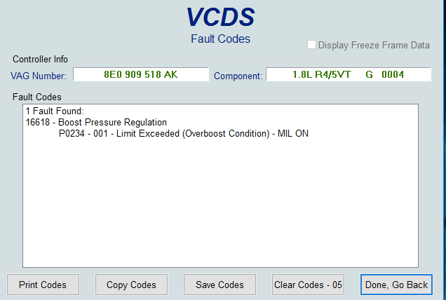

    After 12 years (2004 model), with most of that being APR Stage 1+ tuned on my B6 A4 1.8T, I think the turbo is finally crapping out. This is mainly due to me and a few others noticing for about a year an excessive amount of oil in my intercooler piping, as well as I received this lovely CEL last night following a nice trip down limp-mode lane:

    The oil in the intake track could be coming from the block breathers. If everything isn’t functioning properly it can result in excessive blow-by being sucked into the TIP.
    Your overboost code is much more likely to be from a split hose going to or from the N75. That isn’t a sign of a failing turbo.
    Are you experiencing any other performance issues other than those two you listed?

    As mentioned overboost usually results from the N75 not doing its job properly. The first thing I would do is to inspect all the boost control hoses connecting the high pressure side of the turbo to the N75 and then from the N75 to the wastegate for any cracks or leaks.
    If they are good try pressurizing the hose from the N75 to the wastegate and see if the wastegate diaphragm is leaking.
    An last but not least you can log your actual versus requested.
