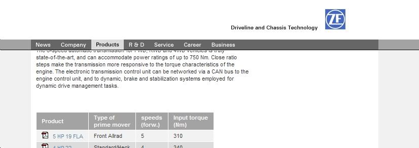

    Last I checked, ZF's website says 5HP19FLA good for 420 nm input torque. Thats 310 ft*lbs force.
    Nope. You may have transcribed the information incorrectly. Take another gander. cheers! Mike

    It did not take any transcription, see here:http://www.zf-group.com/pdf/5HP19FLA.pdf
    Scroll down to "5HP19FLA Technical Information"
    Veteran Member Four Rings pandaxprss's Avatar
    Sep 12 2004
    3457
    Just my 2002 A4 1.8TQ
    ya it says 420 Nm which converts to 303.7469354103838 TQ
    i dunno how true that is though

    Guess my link didn't work. Check it
    All of the 19s series handle Tq load of 300-310NM. It must be a typo on that PDF file.
    1 NM = 0.737 lb-ft
    300NM*0.737 lb-ft = 221.1 lb-ft
    310NM*0.737 lb-ft = 228.5 lb-ft

    310nm which is 224.19416661242613 TQ
    if thats so how are people runing larger injectors programs or even K04s
    Interesting...
    I dont know why it lists it like this...
    Here is the link...
    http://www.zf.com/ZF_ProductDB/user/...e=5hp19fla.pdf
    Not sure why this is.
    cheers! Mike

    I also noted on this ZF document .pdf, that the 5HP19FLA is used with the A6 2.7T, Allroad 2.7T, and the W8 Passat B5.
    All of these motors should be pushing close to or more than 310 nm. See:http://www.zf-group.com/pdf/AppChartpasscartrans.pdf.
