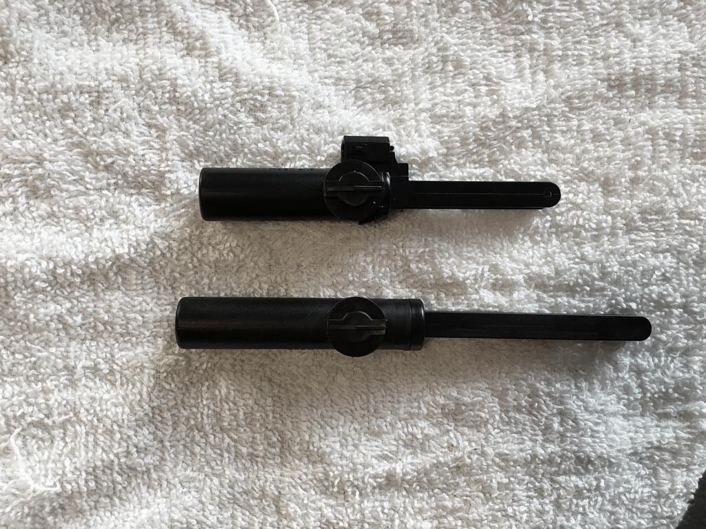

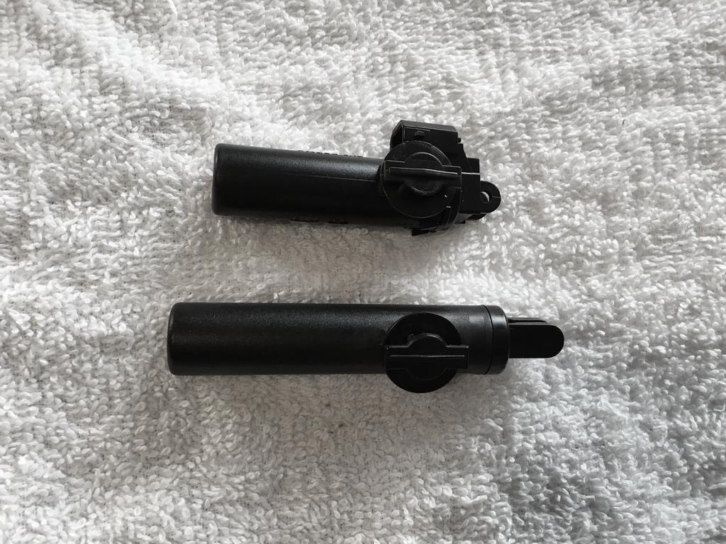

    I received the B6 glovebox dashpot. Unfortunately, while its top mount is the same, the B6 dashpot is significantly shorter than the B5 version. When the dashpot rod is fully extended, it doesn't reach far enough to allow the glovebox to open fully.
    Here are comparison photos of the B5 (longer) and B6 (shorter) dashpots, with and without the rod extended:
    http://www.tikan.org/ti/audi/autiq/dashpots1.jpg
    http://www.tikan.org/ti/audi/autiq/dashpots2.jpg

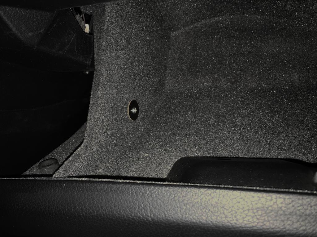

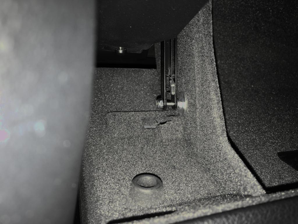

    To make the B6 dashpot work, I had to modify how the dashpot rod attaches to the glovebox lid. Rather than attaching it to the original mounting hook, I drilled a hole on the inside left wall of the glovebox and mounted a 1" long #6-32 machine screw, and tightened with large flat washers and a lock nut. The screw also goes through the holes at the end of the dashpot rod, and capped with another lock nut. The location of the drilled hole is carefully chosen to allow the glovebox to close fully, and will still open wide enough for access to the contents.
    Photos of the modification are here:
    http://www.tikan.org/ti/audi/autiq/glovebox1.jpg
    http://www.tikan.org/ti/audi/autiq/glovebox2.jpg
    The B6 dashpot has an electrical connector that should be left unconnected when used in this way. The dashpot also acts as a switch for the glovebox light, but on the B5 there is a separate switch for this.
