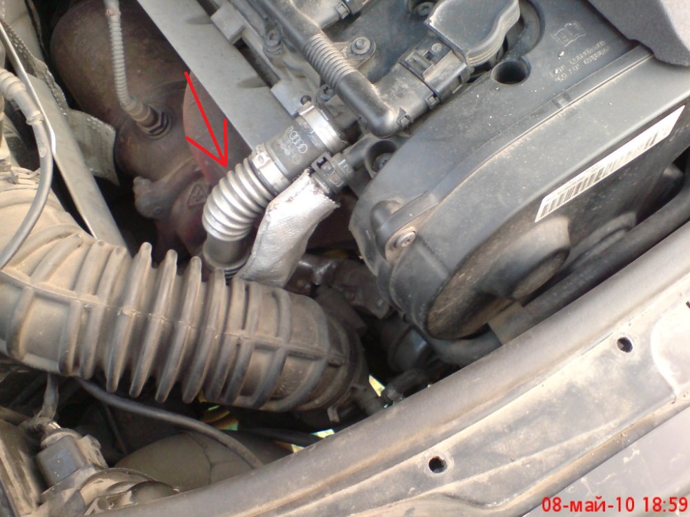

    PCV valve/hose? Help
    I've searched the forums for this and couldn't really find anything useful, or pertaining to my car. Not sure if mine is B7 but here's a pic of my engine. I need help trying to locate the PCV valve/hose cause I already ordered a new to replace it. Btw it's 2005 Audi A4 Base

    It's a b7

    Ohh so it's up under the cover then ?

    Correct take the cover off you'll see it.

    There's two one upper as pictured and a breather tube on the lower side of the engine.
