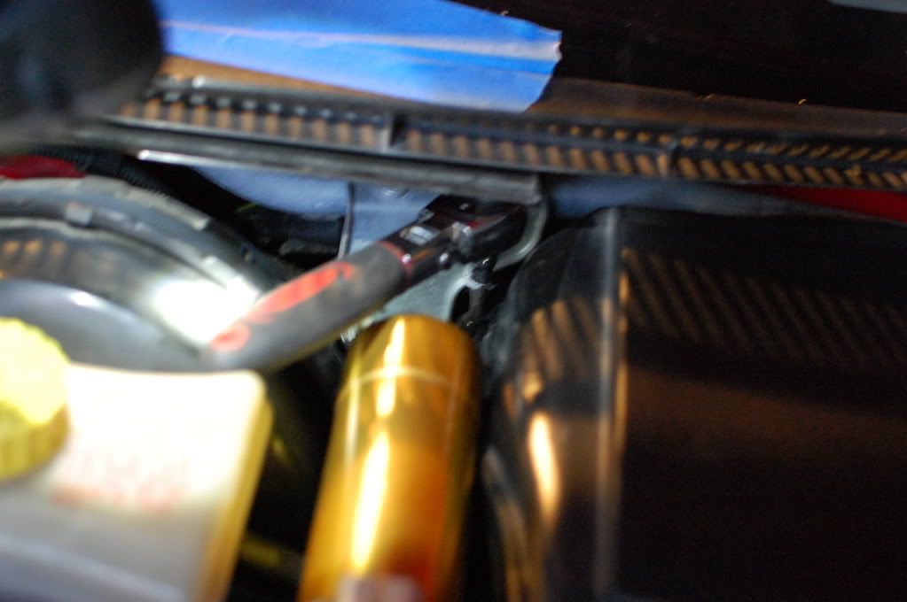

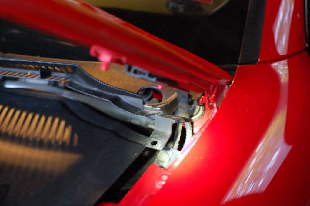

    Remove the cowl clip on the drivers side. It can be seen here:
    Once removed you can pull the cowl up like this:

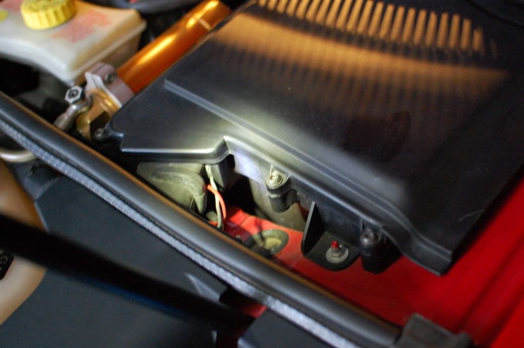

    This will allow you to access the back right screw through the wiper hole. The screw can be seen here:
    My screw is a philips but yours should be a t30 torx. There are 5 total. 3 in the front and one at each back corner.

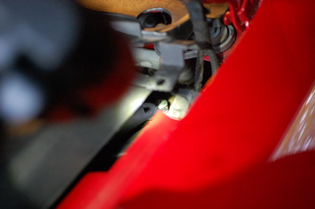

    The back left access can be seen here:
    The front 3:
    After you remove all 5 screws you can remove the ECU cover like this:

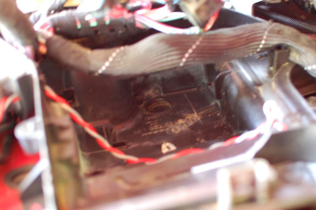

    After you free the ECU you can pull it out of the way and you will see this:
    Another shot:
    I could see water in the ECU box but had already removed it at the point of this picture.

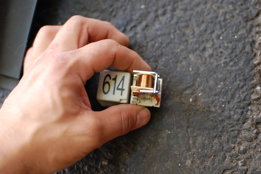

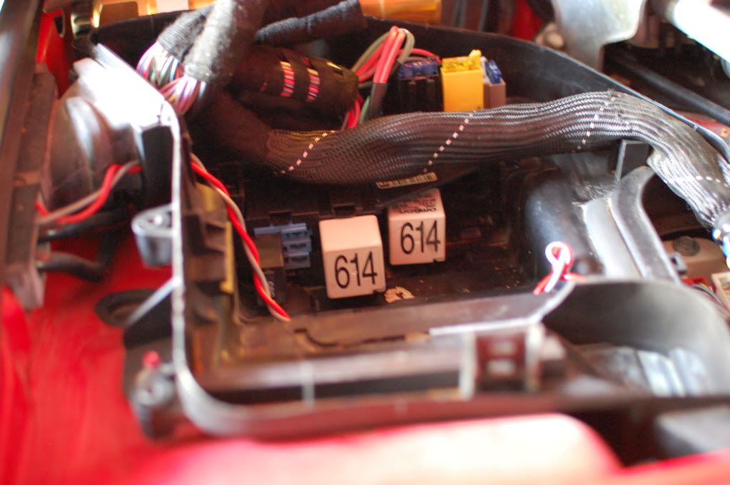

    I believe the middle relay is the cooling fan relay. The whole relay/harness holder can be lifted up to remove it from the ECU box as shown here:
    After you remove the relays you can remove the harnesses if you wish to make cleaning them easier. You will see the two locking tabs that hold them in place.
    This shows the relays removed and in the correct orientation:

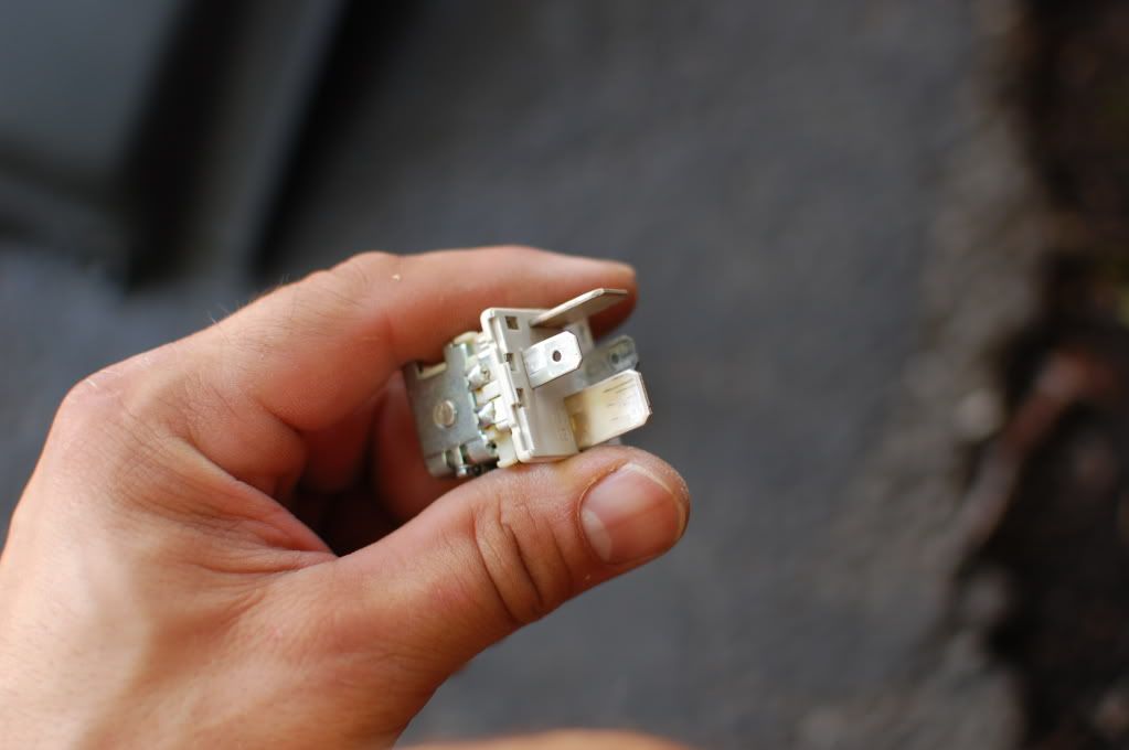

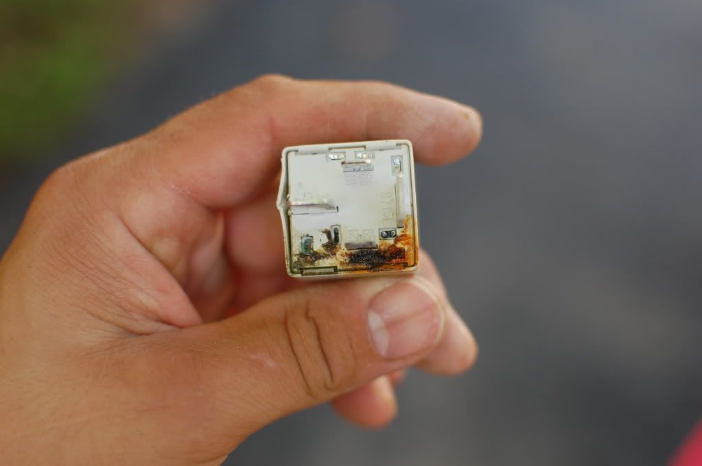

    I opened each relay up by prying the locking tabs open with a small flat blade screwdriver.
    Here is an open one:
    Here is the nasty one:

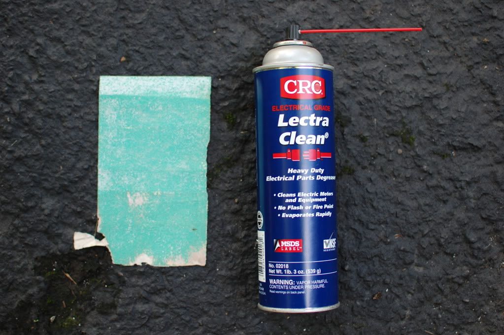

    Here is what I used to clean them with:
    I sanded the terminals down and then sprayed them with electrical contact cleaner. I also sprayed the relay side. Wear gloves with this stuff, it starts to burn your skin.
