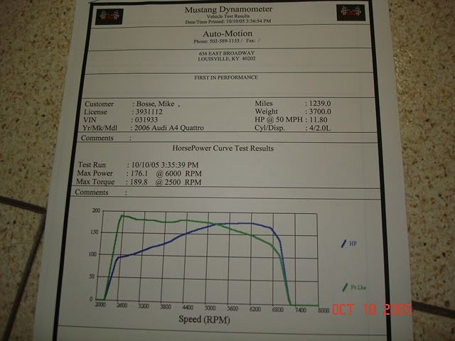

    Stock 93 Octane Dyno of B7 A4 2.0T Quattro 6-Speed on the Mustang...
    Well, the numbers are high just like some others we have seen. Very intersting. This was done on pure Shell 93 Octane fuel. We kept looking at the dyno wondering if it was reading wrong, but we entered the current weather conditions correctly and sure enough a stock B6 A4 170bhp car dynod at 136whp on that dyno, so apparently Audi may have underated these cars. Perhaps so as not to take away from the V6 sales. Other suggestions?
    Here is a 3rd gear pull...

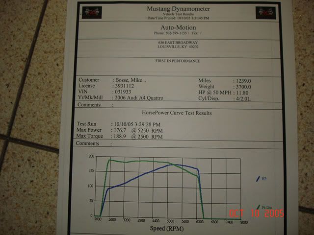

    Here is a 4th gear pull...
    I was told this dyno can correct for the gear used. Apparently this is the case.
    Notice the 4th gear pull is only to 6200rpm. Well, I was going about 120mph on the dyno at the time and there was so much load, I just shut it down. I see why tuners are using 3rd.

    hmmm seems close to what we dynoed. 3rd made more power then 4th.
    4th gear pull was 179whp and 190 wheel tq seems to be about the same pwer just different gears
    third was a bit higher

    WoW so what is that about 220 hp at the crank, thats pretty crazy. It also looks like the power band is pretty smooth throughout.

    I'm not too familiar with dyno ratings and comparing whp and crank hp - but it does seem that our B7's are pulling over the posted 200hp?

    4th gear pulls on Mustang should be fine.. At least in my experience in the Mustang the car did fine in 4th gear..
    Whatever you are comfortable with though..

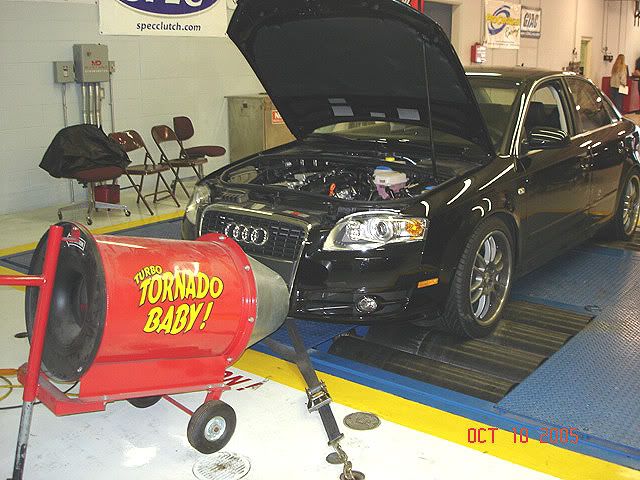

    Nice stock numbers BTW.. Love the turbo tornado..
