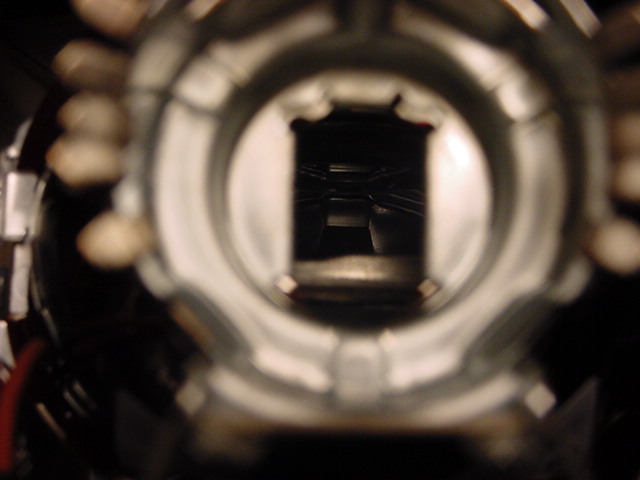

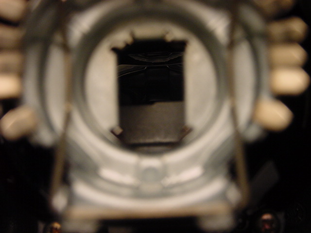

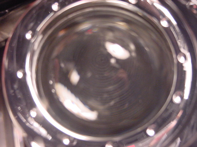

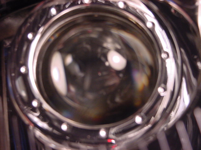

    DOT cutoff shield:
    Ecode cutoff shield:
    DOT lense:
    Ecode lense:
