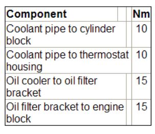

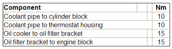

    can someone tell me the torque specs for the bolts on the OFH?
  15. #55
    Veteran Member Four Rings mtroxel's Avatar
    Feb 24 2004
    858
    Minneapolis
    Note these are all in Newton Meters.
    11 A4 Q, Prestige, Black
    207,000 miles, APR Stage 1

    Anyone have the torque specs for housing to block and cooler to housing?
  33. #73
    Feb 24 2004
    858
    Minneapolis
