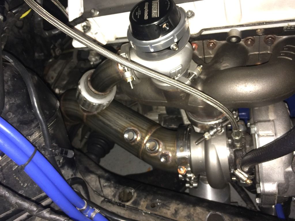

    Well I went out and ran it on the track on thursday. It ran well, and i learned a few things.
    1. I should always replace my spark plugs before the track, I was getting some misfiring that pegged my afr gauge to the rich side under boost. ran really well up to about 12 psi, then started getting funny. didnt do it on the dyno a few weeks ago though, so the only thing I can think of is the plugs went to shit. I run the ngk bkr7e's that everyone says are great. I put in a set of bosch f6dtc's now, and we will see if they are better.
    2. I cannot keep the exhaust manifold tight to the turbo for the life of me. Next thing I am trying is ARP hardware that hopefully is stronger and doesnt stretch, but the turbo loosened up from the manifold by the end of the day, and i was able to hand unthread the studs.
    3. I need fender flares, rubbed the side of the slicks a bit when I was cornering hard.
    But most importantly, I drove it home, and had some fun. oil temps never got above 210, and water stayed under 200, and everything else held up well. If anyone has pointers on the above problems, let me know. I am ready to jb weld the damn studs in the manifold. if new hardware doesnt work, I am just gonna buy a v-banded setup and be done with this crap.

    Quote Originally Posted by Schrubbe8210 View Post
    Historically this has been a pretty major problem for FrankenTurbo owners, obviously this is different compared to your setup but same application nonetheless.
    One option is a bolt locking tab - in your case it might be 4x bolt locking tabs that get bent to hold the nut in place and prevent it from spinning.
    Another option is safety wire - this may be more difficult with your bottom-mount turbo setup, but it's a sure way to solve the problem. Here is how it looks on my FrankenTurbo setup:

    Yeah, that looks like it would work, problem is, access is gonna be a royal bitch, and i don't know if I can get bolts to fit yet, I am taking it to my local race shop to tell them to handle it. I am sure they know how to address it, and probably have much better tools for this sort of thing than I do. If i could get bolts under there, the tabs or wires would work great. It also bears mentioning that it didn't loosen until I really beat on it. I have been driving the car around for a month or so without problems, and thought this headache was gone.
    Thanks for the info!

    Just found my bolt loosening solution. A product called Resbond. High temp threadlocker, good to 2300 degrees. Ordered a bottle from mcmaster carf with some new locknuts, and gonna tighten this bitch up once and for all this weekend. IE and 034 confirmed that stuff is the shit and will keep my exhaust bolts tight. Resbond 907ts made by cotronics.
    Ill update once i heat it up again.

    I had pretty good luck with nord-lock washers. But I suggest 10.9 with them, the 12.9 was too hard.

    Custom. They're from McMaster-Carr, M10x1.5 80mm length I believe, and trimmed shorter so they don't bottom out. I drilled the holes in the bolt heads with a drill press for the safety wire to pass through.

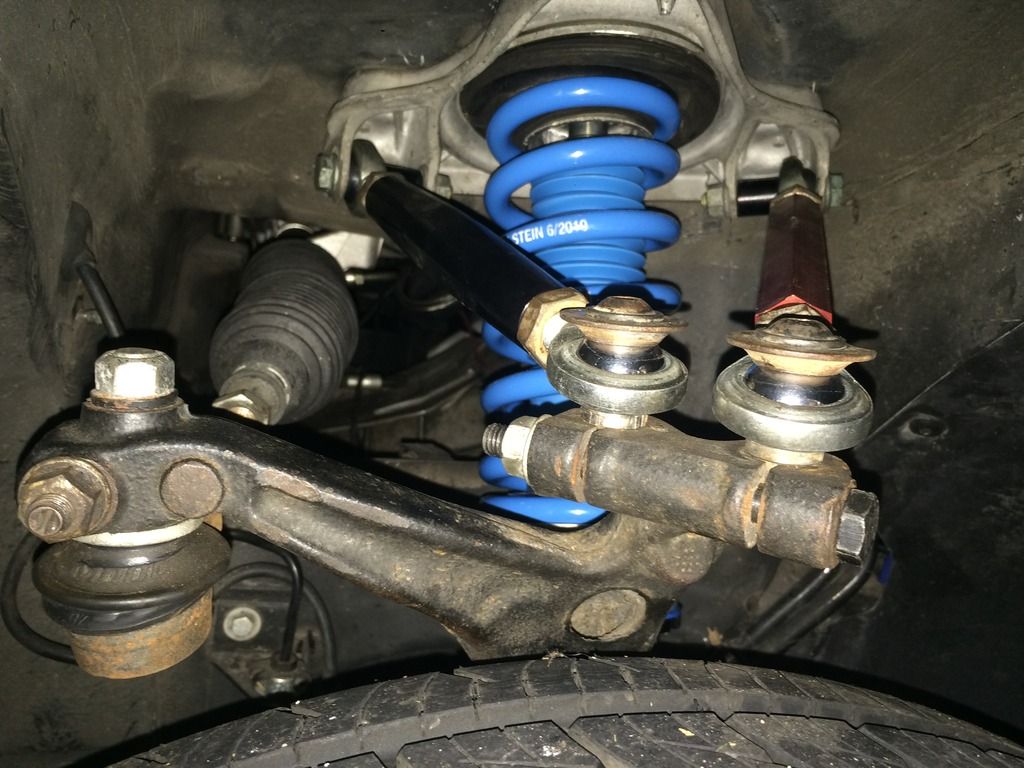

    Interesting, was a diagram of upper control arms potions provided? Mine are dead center on the upper perch.
  38. #198
    Veteran Member Three Rings Schrubbe8210's Avatar
    Jun 16 2012
    95341
    1997 B5 A4 track car, 2017 Q7 Prem Plus
    Elm Grove, WI
    I called 034, when they redesigned them, they shifted the bearing out. they way they are installed in the picture is correct.
