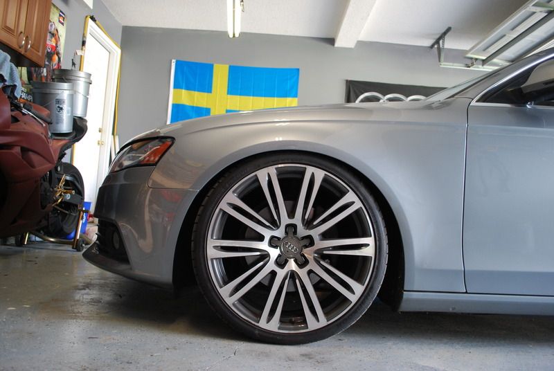

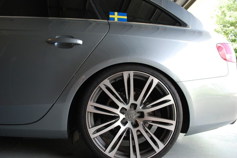

    Offset is not an issue, and you will be fine but you will have to change the tyre size. I have a 255/30/20 here are some examples of mine

    Quote Originally Posted by bluetori View Post
    That looks incredibly clean. Well done.

    Thanks I have constantly had people stop me and ask me about it.

    Cool, thanks for the pics and the tire size tip. Your A4 is the same color as mine and I see you are in Georgia as well. The wheels are painted black, but I will probably have them stripped to get back to the original finish so it seems I'll be a copy cat! lol

    Glad you like it quartz in a great colour, your going to want to lower it though.

    No spacers 9x20 et 37, suspension is Vogtland coilovers I need to raise the rear up a lil bit.

    What a great stance, very nice.
