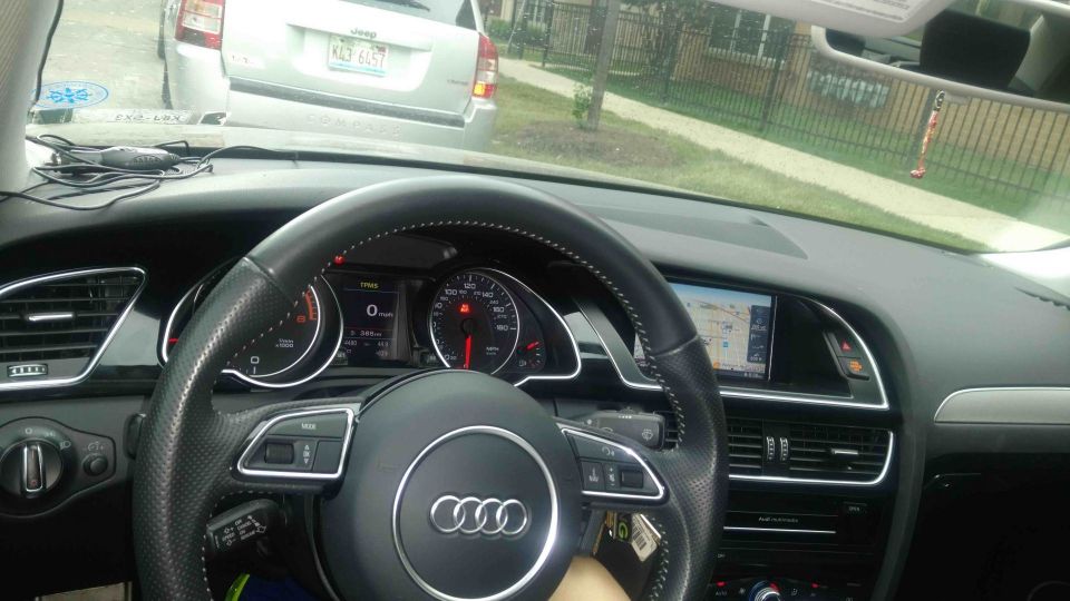

    notice the sick RS5 piano black instrument surround.
    I really owe the community some nice interior and exterior pictures at this point. It is a thing of beauty, IMHO :D. I also did the rear taillight FL retrofit recently.
  12. #52

    Quote Originally Posted by gtg196w View Post
    Nice! I like it!
    Two questions: Why do you have both key fobs attached to each other? Also did you get the push start to work or going to do that retrofit?
  13. #53

    The other is for my Q5. No push start hehe. I think i'm done with having the interior in shambles. Need to clean up the B&O retrofit that's half done, seats are in. I think i'm done on aesthetics at that point. The only things I'll do in the car's lifetime is coil-overs once the stock shocks go in about 10k, and a K04 when the stock turbo goes.
