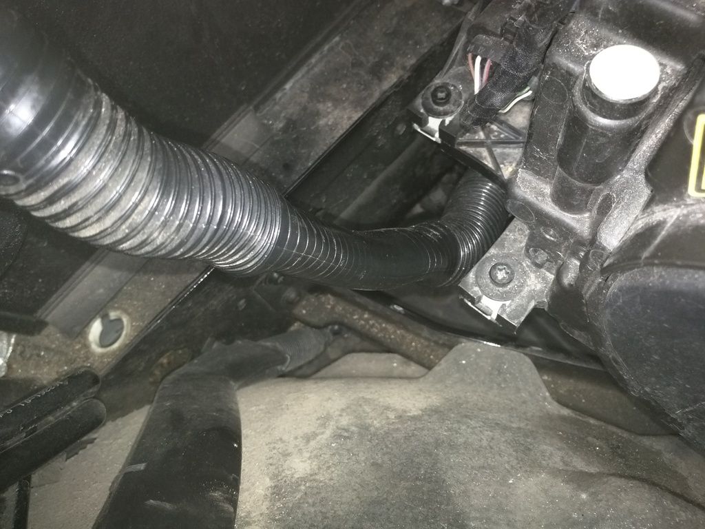

    So I took my intake filter off and looked under and the breather hose was just sitting under the intake kinda smashed. Here is what the breather hose looks like:
    Is it normal for the hose to look smashed like that? Also what does a breather hose do exactly?
