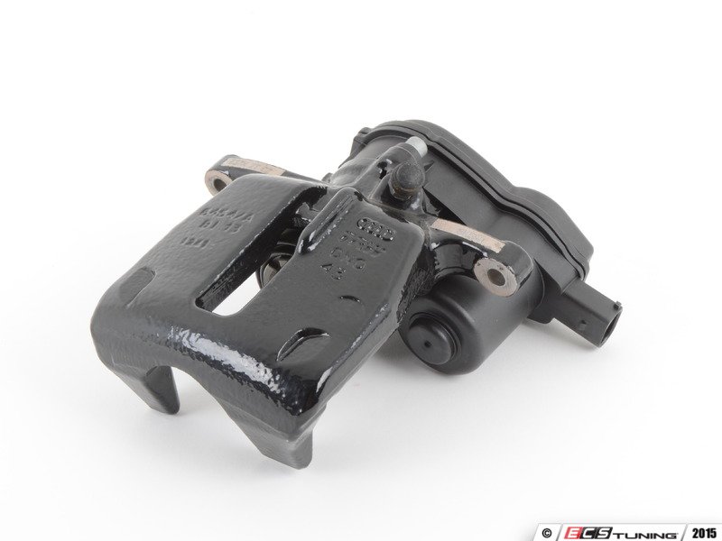

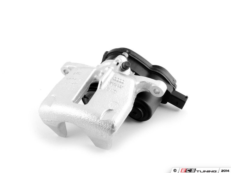

    My findings point to A4 and S4 calipers are difference despite what ECS says and a few people on here. S4 calipers are wider to account for the wider, vented rotor. I'll be looking for S4 calipers now so if anyone wants to sell, PM me.
    It only took me 30 min to change back to my old setup on both sides. My best time
    http://www.audizine.com/forum/showth...9#post11333679
    Mfg Part #8K0615403A & 8K0615404A
    You can see the difference in the width between the two:
    A4 Caliper
    S4 Caliper
    Cheapest I can find for S4 calipers:
    http://www.ebay.co.uk/itm/Audi-Brake...-/331703890065
    http://www.ebay.co.uk/itm/Audi-Brake...8AAOSwI-BWQLeG
