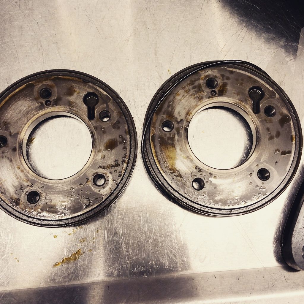

    I am currently having this job done on my own vehicle. Mechanic and I are undecided on whether we need to replace the mechanical adjusters. I have attached photos of my current ones. The left hand side is Cylinder 1-4 and right and side 5-8. Note that I was getting misfire codes for cylinder 1-4, but had no cam related codes at all. These are not a cheap part for me, especially after converting to my currency and including import fees and freight charges.

    ^^ The one on the left definitely needs to be replaced, while the one on the right doesn't look too bad.

    Does anyone have a good 2nd hand pair of these they are willing to sell and ship to NZ?
    I would imagine that would be a cheap alternative if you didn't want to spring for the JHM ones. Plenty of people like me probably have a set that look damn near new.
    These are the ones in my garage right now. PM me if you want them
