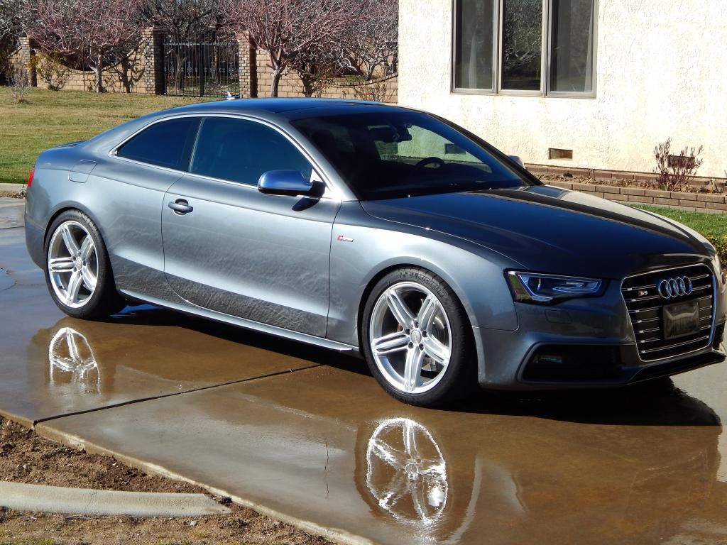

    I think you will be fine with 15/20s. I run those spacers, with coilovers, no rubs for 99% of the time. (Extremely occasionally a minor rub on rear if there is a big bump and cornering at same time.)

    Quote Originally Posted by u2nelson View Post
    [IMG]http://i1279.photobucket.com/albums/y526/u2nelson/Audi%202013%20S5/035f0412-bc53-4931-96e0-8b9d77d723a9_zps4zxktqjy.jpg[/]
    Looks like you are running PSS too which are beefier than most tires

    Actually the PSS run a little small, which is why I stepped it up to 265/35 vrs stock 255/35. I found the PSS 265s where almost exactly the same fender gap as the Dunlop 255s I was running. IMO you can't beat the PSS from a handling/wear/cost/noise/comfort combination, its an amazing tire.
    Hmm interesting. Doesn't seem to be the same opinion as most on here.
