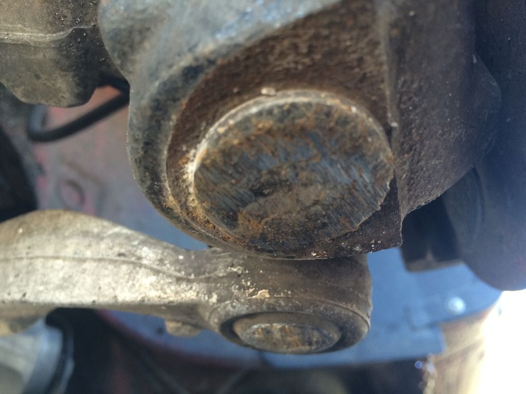

    Which of these needs to be replaced? (Wheel fell off on highway)

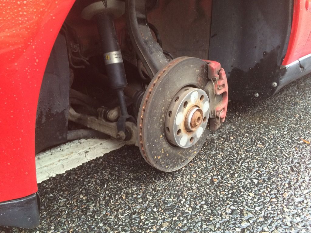

    So as some of you already know, my wheel fell off when I was driving (going about 40-45). I was able to stop pretty quickly but still skidded some. The wheel is trashed, but none of these other parts really look that bad. Which (if any/or all) of these should I go ahead and replace? Hell even the brake rotor looks untouched
    How it was on the side of the road:

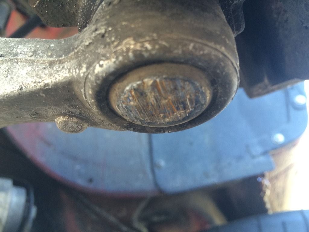

    Ball joint?

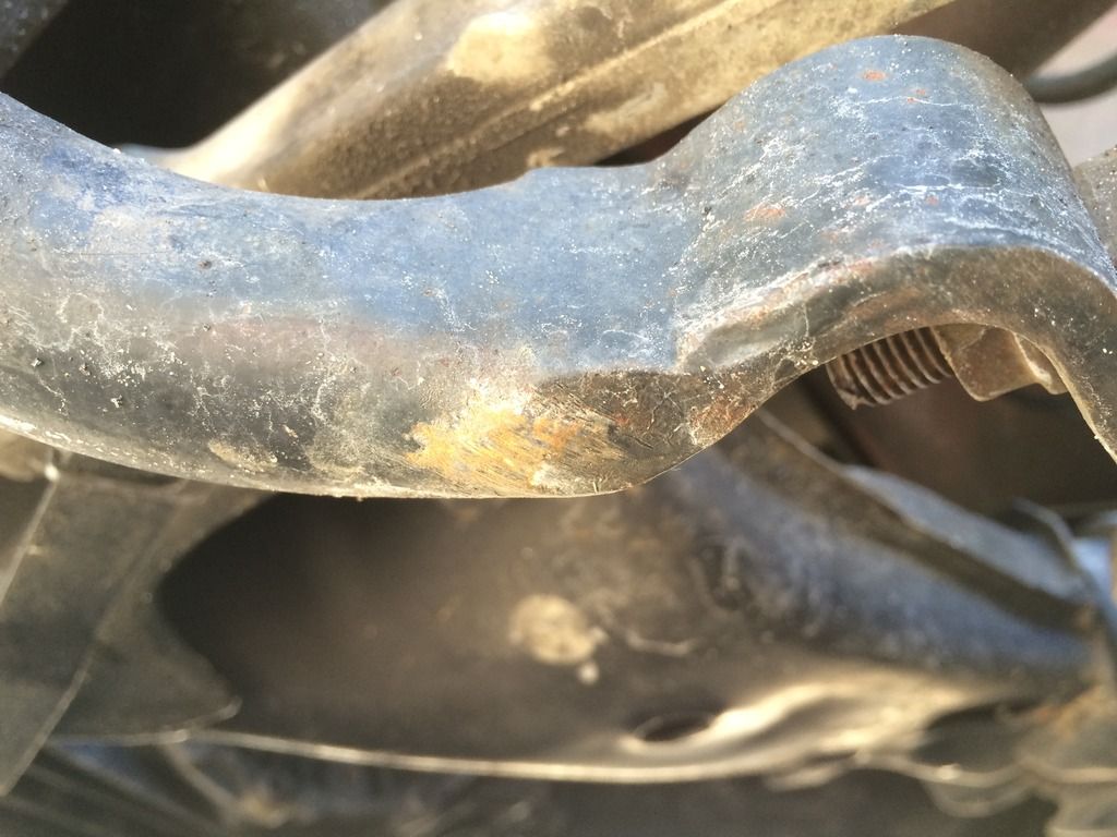

    Lower control arm control (I believe):
    Sway bar doesn't look hardly touched

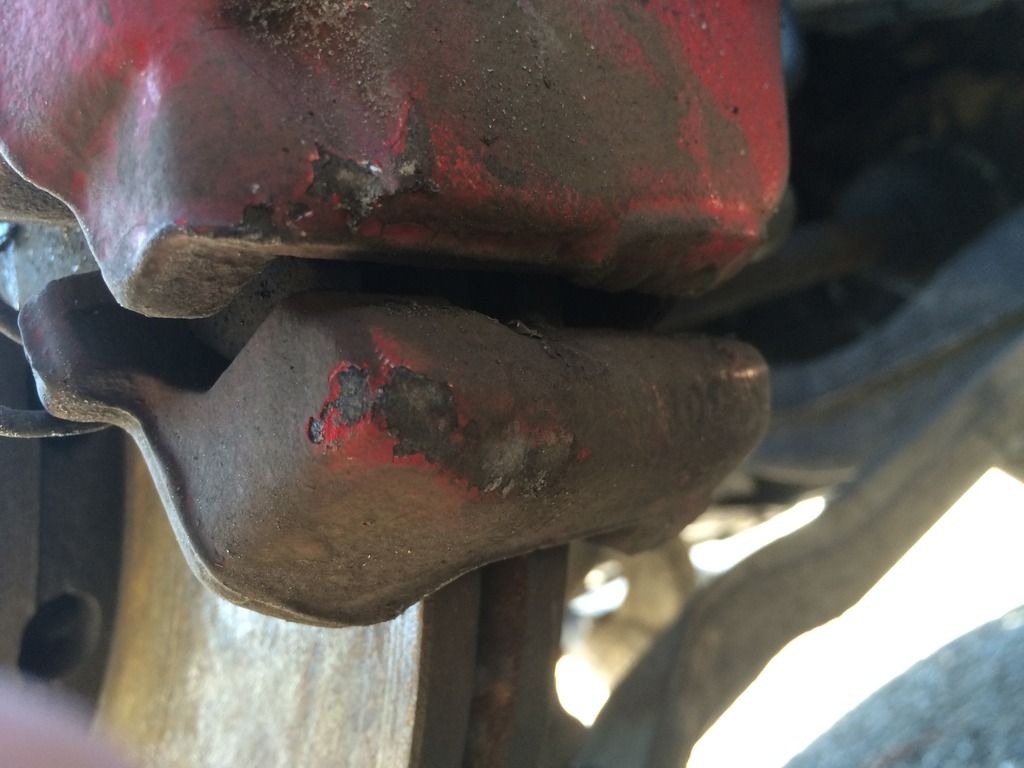

    Brake Caliper:

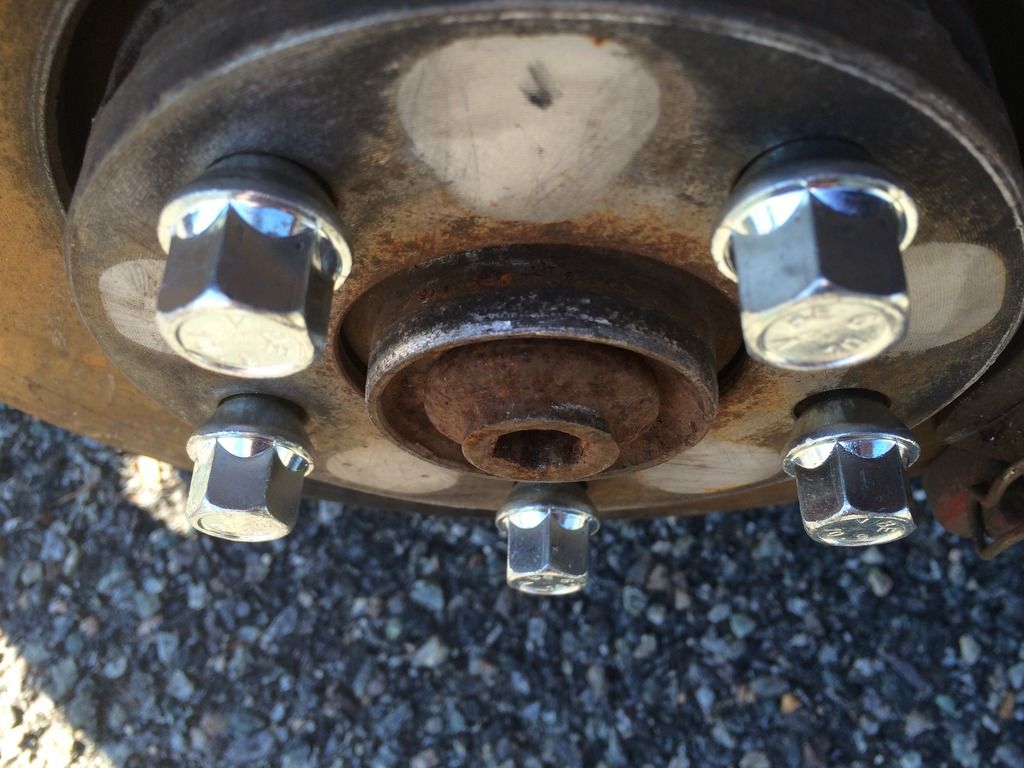

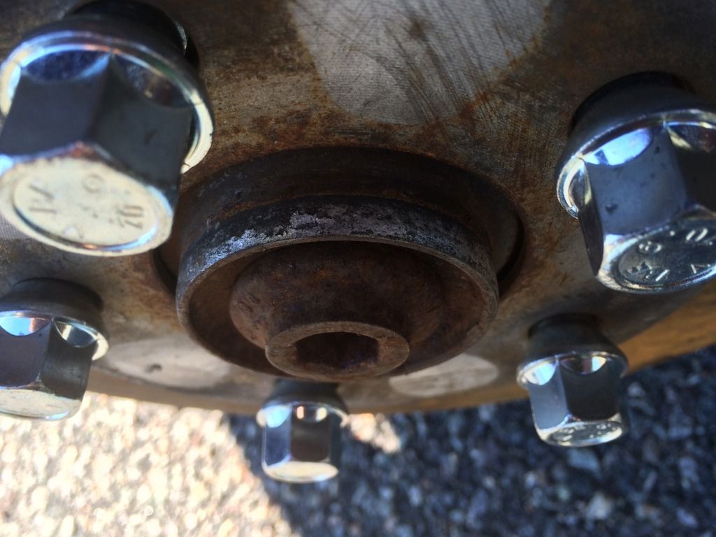

    Hub, all 5 lug bolts went in without much effort at all and held, the center ring took a hit but doesn't even look bad (mind you I will be running hubcentric rings later):

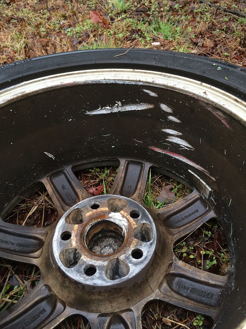

    If your lugs hold fine how in the world does your wheel fall off?

    Quote Originally Posted by mpsmith View Post
    You got me, I found all 5 lug bolts and all 5 had the last 3-4 threads shredded off cleanly. OEM bolts too.

    Quote Originally Posted by ENVē View Post
    How did this happen??
    Not a clue, I had the wheel off about 4 days ago so I must have over or under tightened the bolts. But I used the same impact I use on all my cars and on another wheel the same day and that wheel is still tight. Not a freakin clue.

    Those are Coneseat bolts.... Most likely Not OEM, if you are using those bolts pictured in an OEM wheel thats probably the problem.
    Still strange Did you use a Torque wrench?

    Quote Originally Posted by rodgertherabit View Post
    Those are just the bolts I had at my house for my new wheels. The ones that were on when this happened were stripped so I threw them out. These are just conical seats from ecs.
    I didn't use a torque wrench to check them (will be from now on), but we have been using the same settings for 15 years and the other wheel I did the same day is still fine and tight. Idk.
    Does anything actually look like it needs to be replaced? I keep looking over it and don't see anything bad somehow. I even mounted the wheel back up just so it doesn't look so shitty in my driveway. Obviously I don't want to replace anything that doesn't need it, but at the same time I don't want this to happen again...

    Veteran Member Three Rings S4NIK8's Avatar

    The front lower control arm looks like the nut is completely ground off; I would replace that for sure.

    Quote Originally Posted by S4NIK8 View Post
    Front lower front?
    https://www.fcpeuro.com/products/aud...ont-4d0407151p

    Yes. Front Lower Front.

    The only damage is pictured, I got extremely lucky that it didn't touch the oil pan or anything else for that matter.

    Cool thanks, is the front lower rear arm gunna be hurting with that little bit ground off?

    Nope, did not scrape. Trust me, I took an extremely good look. With the wheel off, the oil pan is about 1/8-3/16" off the ground. Because the front right tire was still up it held the undercarriage just enough to not screw me. Thank god I wasn't lowered yet

    OP, were you running any spacers with the oem lug bolts? The only thing is if you didn't have enough threads, over tightened the lug bolts, and stripped the threads off.

    No spacers, just the OEM wheel and the OEM lug bolts.

    Wheel not centered when you tightened the bolts. Even properly torqued, bolts come loose when wheels settles in. Normally strong wobble felt. Had it once happen on wheels with hub centering rings. But caught right away. Rusty hub can also cause mismount (feels tight but isn't).
