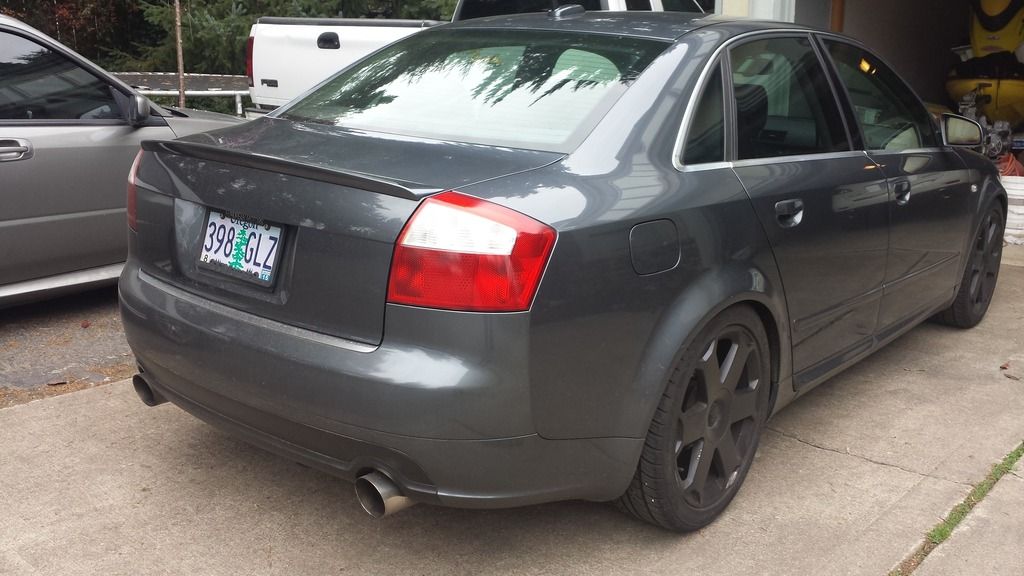

    Also the tailpipes get moist and after a while start to drip water.

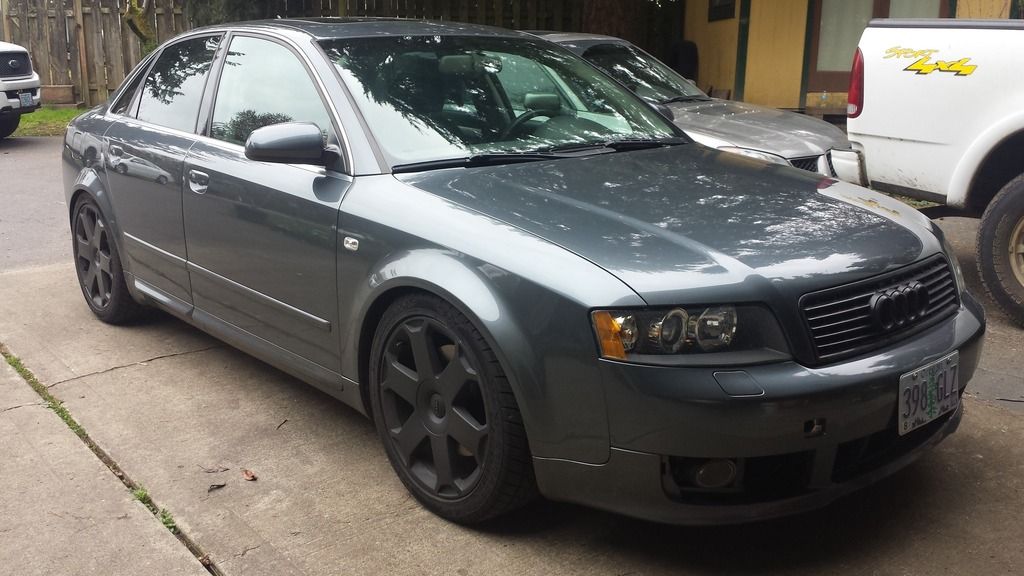

    Does anyone know this car? Maybe know the history?
    Here are a couple quick pics

    Water is a byproduct of combustion. Condensation in your exhaust pipes is completely normal.
