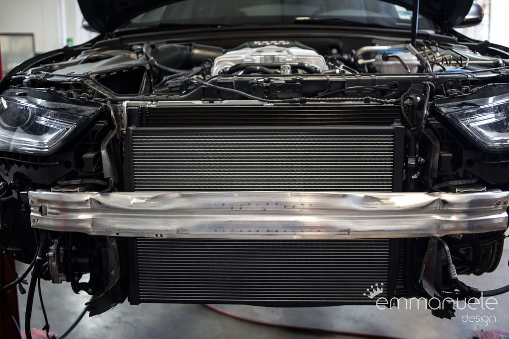

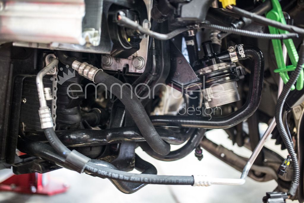

    We recently had a chance to install the new cooling system from Forge Motorsport. The kit includes the larger front radiator, coolant reservoir and new hoses. As soon as we unboxed the item, the quality was apparent. The brackets were nicely welded onto the radiator, and you could tell that everything was built specifically to suit the car. The kit came with all new silicone hoses, so we did not need to trim the factory hoses (something that takes a decent amount of time). Forge also added a nice touch on the coolant reservoir by using an OEM cap and machining a Forge cover to fit over that. We've had issues in the past with fully aluminum caps becoming seized on the reservoir after extended driving.
    In terms of the install, it went beautifully. Having replacement hoses means that you save a ton of time by not having to cut your OEM hoses, and even better is that you can go back to stock in the future by just swapping hoses (as opposed to buying all new ones since you had to cut the OEM ones). The brackets are already installed on the radiator, so you only need to drill the crash bar for mounting. The reservoir installed using mounting holes that are already on the vehicle, so we did not need to drill any new holes. Overall, we were very impressed with our first experience with the Forge unit, and it will likely be our system of choice from here on out.
    Currently, we have limited availability on these units but please contact us for delivery ETA's. Pricing is $1450 shipped in the United States. Available through our website here.

    Interesting, any picture showing the res installed? I like that it uses a factory cap as an option. One interesting thing is they created a new loop for the coolant instead of the other designs that just have a fill res.
