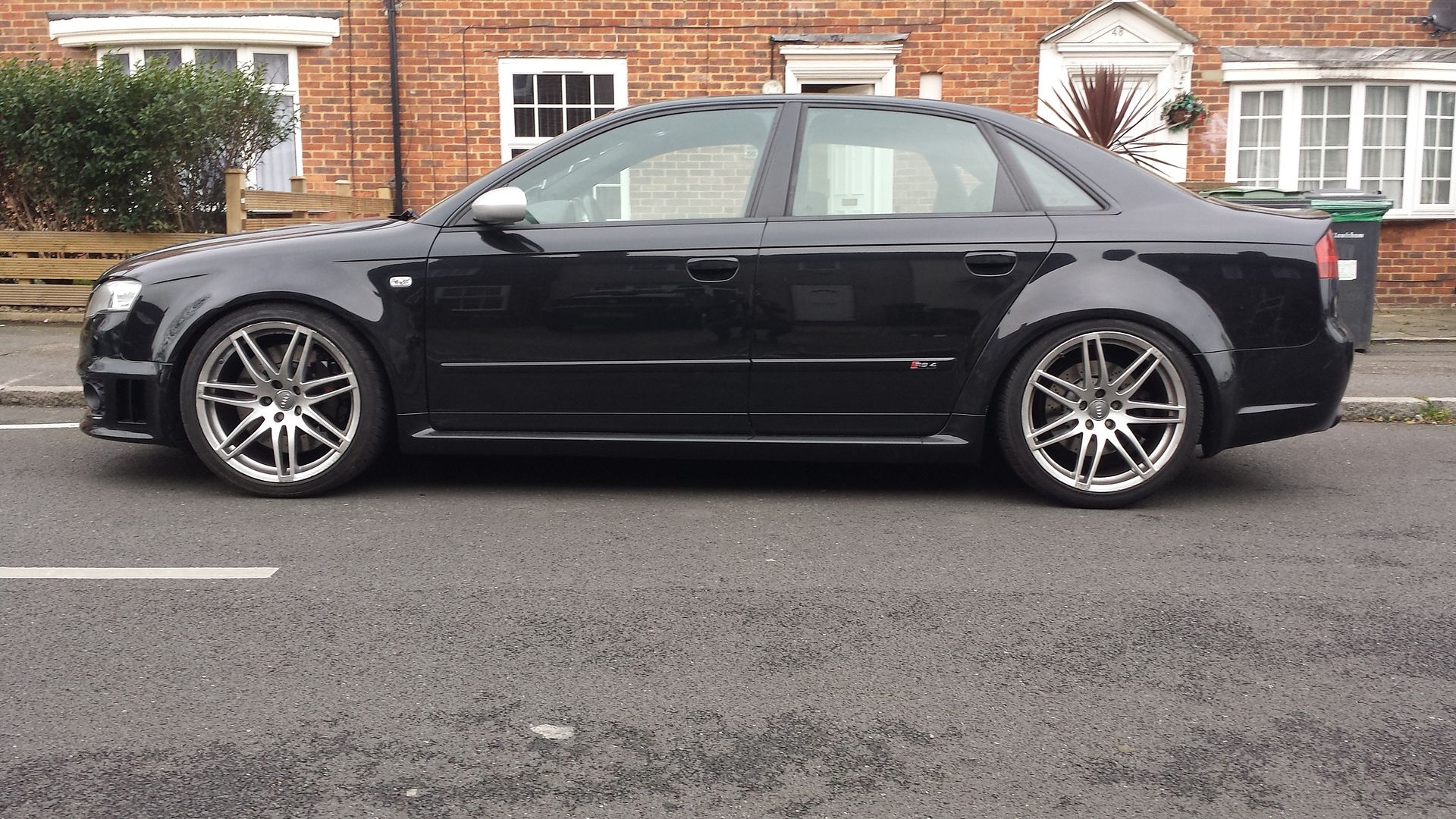

    Before:

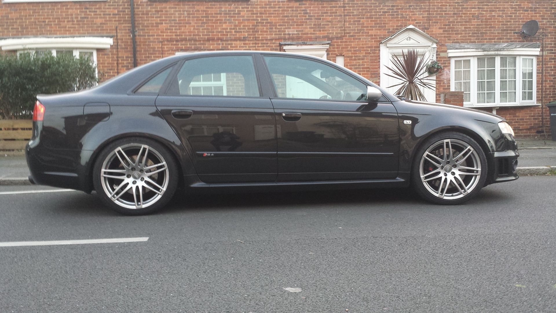

    After:
    The rear is on the maximum lowest setting (only way to get it in to the car)which I'm going to adjust as its tool low for me and the front is about midway.

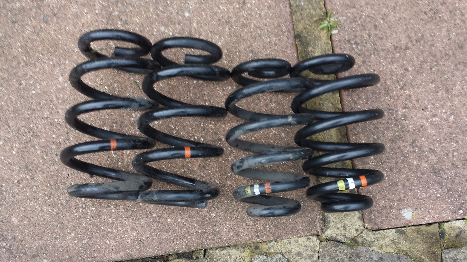

    Heres a picture of the SS Plus spring colour markings.
    Only a little London driving and I will say she feels the bumps a little more for sure but not so much I could not live with just a little more than stock.
    I will be the weekend before I will get to see what she like on the open road but for now I'm happy just need to raise the back end a bit, oh and I noted the N/S gearbox rubber gaiter was shot so I will take it to my mates Shop for him to sort it out think I've had my fill of DIY for the moment.
