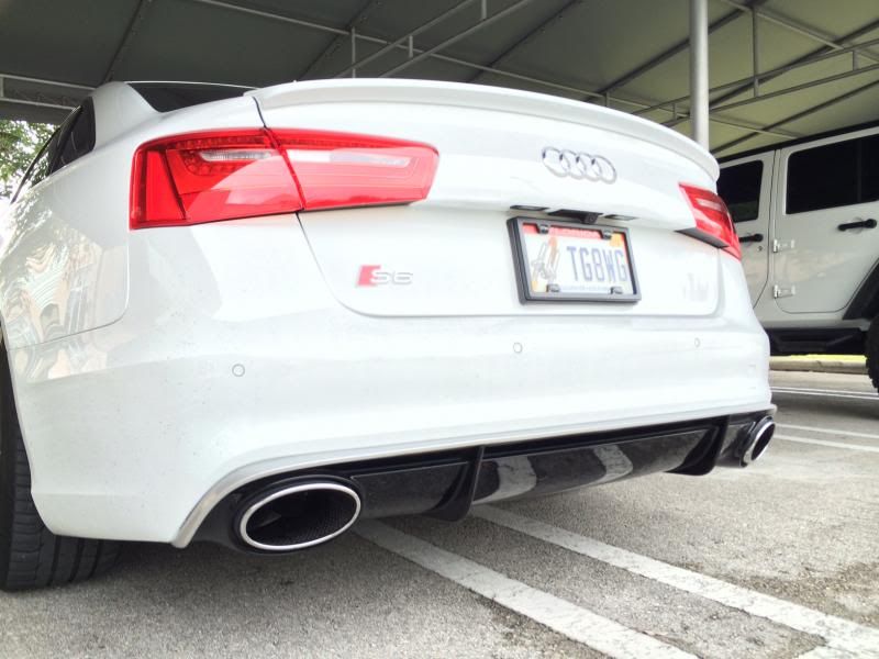

    I put an RS7 rear diffuser and oval tips on an S6. It took a lot of body shop work primarily because the tabs on the RS7 diffuser didn't line up with the holes on the S6 bumper. I have a sneaky suspicion that they will line up perfectly on an S7. You shouldn't need to buy a new bumper, you should just need to buy the diffuser, the oval tips, and some brackets which all show up on the RS7 rear bumper diagram.

    Oh, and you're going to have to cut your stock muffler tips just after the valves.

    Where did you get the oval tips S6E?

    I bought all the parts from my Audi dealer.
    Do you have partnumber for this RS6 diffuser? Can you share pleae?

    Wow this looks so much better then the stock one. [Looks meaner]

    I agree. I always thought the S6 diffuser was so conservative. It cost me about $2500 by the time all was said and done in parts and body shop, but well worth it IMO.
    Beaver, I'll post the part numbers of the parts I purchased when I get to the office tomorrow. I have the car file there.

    Here are all the part numbers I ordered:
    4G8-807-521-T-AP6 SPOILER (Gloss Black Diffuser)
    4G8-807-319-A PLATE
    4G8-807-320-A PLATE
    N-907-758-01 BOLT X 16 PCS
    N-015-437-4 SPEED NUT X 16 PCS
    4G8-253-823 OVAL TIP
    4G8-253-824 OVAL TIP
    All in I paid $1611 plus tax (I have a 20% resellers discount form the dealer). I also paid the body shop $800 for the custom install. My parts had to all be repainted by the body shop due to the cutting, gluing, and contouring required to make it work on an S6. I don't think that will all be necessary for an S7.
    That is sick!

    You mean like these here?
    May fit.... ?
