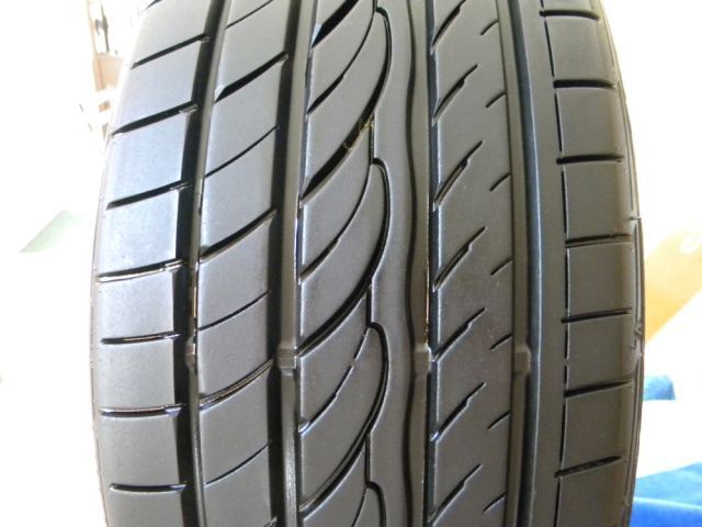

    Maybe tell us what tires you actually have.
    Yes, some are directional, some are inside outside. Inside/outside tires will look that way. Just check that all four say "outside" on the outside sidewall and aren't mounted on the wheel in the wrong orientation, otherwise that's how they will look and you're good to go.
    For example this is what my summers look like, Sumitomo HTR Z III's. They are asymmetric, inside outside, tires. You can see how you might wonder if they were directional but they are not.
