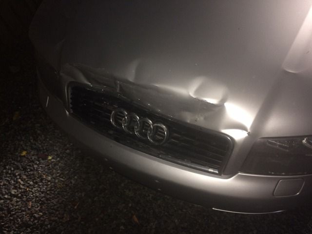

    Long story short... Went through some snow that was plowed in front of my girlfriends driveway, ended up being very hard snow. Tore my lower bumper off, and dented my fender. I'm not sure how, and I don't really care at this point.
    Was going to claim it on insurance, but they were going to total it.
    Sooo I'm going to fix it myself.
    It's probably going to take some time, mostly posting this so I can keep track of what I'm doing.
    At least with no lower bumper I can finally get up on a pair of ramps.
    Excuse the pictures, they were taken by the insurance/collision center
    The extent of the damage:
    Bent fender.
    And a cracked core support
    I'm not sure what I'm going to do about the core support, I believe it's existing damage from a previous accident. Replacing it looks like it's going to be a pain in the butt, and a little pricey.
    Possibly plastic weld? Maybe drill a couple holes and put a aluminum brace to keep it up.
    Gonna be rockn' no front bumper and a bent fender for a while though.

    How exactly is this a terrible idea? I've sourced a black fender and bumper locally. The core support as well.. if needed. I'm if not mistaken, the core support simply mounts the fans onto the radiator.

    not to mention thats very little damage, and 100% fixable, then only time you have to be concerned is frame damage. They have just probably never done major work on a car.
    That's what I'm saying. There was no impact, I simply pushed snow out of the way to get into the driveway. Dumb? Yeah, but nothing I can do about it now,
    They quoted me an entire new front bumper. The USP upper is $700 from the dealer, plus the lower, $300. Belly pan $259, core support $400. Not to mention the USP grilles, so another $300.
    There was a total of $2,800 in parts they quoted, all from the dealer. And most unnecessary if I fix it myself.
    I figure for $500, which was my deductible, I can at least get the fender fixed and the bumper replaced. (A normal upper converted with my USP lower I already bought a month ago)
    A guy I work with does body work on the side and will paint anything that needs painted for me, for cost of materials.
    Does anyone know if I'm actually correct in assuming the core support only mounts the fans onto the radiator?
    If it actually supported something, I'd be worried about just patching the problem. But if it's just holding those fans it'd probably be fine just leaving it... Looking at the picture one ECS it looks like there's plenty of support left anyways.

    the plastic or the metal behind it? If its just the plastic that took damage patch it.

    some of you guys are exaggerating. this is not bad at all. i'd be concerned if the car was smashed or had frame damage but this is nothing.
    fix it and keep the car man!

    FYI aftermarket core supports are pretty cheap. I would just get a new one. They're also not tough to get on. You can pull the whole thing pretty quickly.

    you can get a new core support for 200-350 last i checked. with a 500 deductible i'd have insurance fix it.

    Found a core support for $67
    If the person I'm buying the bumper/fender off of can get close I'll just pick his up while I'm down there.

    DO NOT GET AN AFTERMARKET CORE SUPPORT. I have been through two of them (each from different suppliers) and the fitment is absolutely terrible. Try and find a parts car where you can get the whole assembly for cheap. I got a complete front clip for $100 off a car some kid was parting out.

    The core support pretty much holds everything on your front end on. Radiator, headlights, fans, condenser, front part of fenders. The aftermarket ones are so bad that you will have trouble lining up your fenders, bumpers and headlight. Ask me how I know.

    I don't see anything that needs fixed on the core support. Looks like something hit the bottom and it cracked there. It's well outboard of all the important stuff. I would just leave it be. Like you said, it was probably from a previous accident and has been there the whole time. Put a couple scews and a little metal strap or just pull it together with mechanics wire if you must.
    Fix the fender and bumper and be done. Then go buy a Jeep if you want to go all 'monster truck' on random piles of stuff. lol

    The core support holds the radiator, and the hood latch too. That is why Audi calls this part the "latch carrier".
