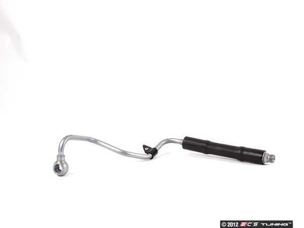

    What is this part?
    Hey guys,
    This part is leaking (what appears to be oil) and I can't figure out what the part is or the part number. It is on top of the passenger side valve cover. My car is suffering from a stumbling idle, and is hard starting, however seems to drive fine once otherwise (no random misfires while accelerating, etc.). I replaced the fuel filter and spark plugs and it didn't resolve the issue. I am probably going to change the coil packs just because I believe they are the originals, and I'm at 130k now, but would like to get any other minor issues fixed first.
    Junior Member One Ring
    Dec 26 2014
    305946
    Yucaipa
    That is the power steering pressure hose

    Awesome! Thanks guys. That would explain why my power steering turns into a dying whale when the weather is cold. Doesn't fix the idle stutter though... guess I'll change out the coilpacks and see what happens.
