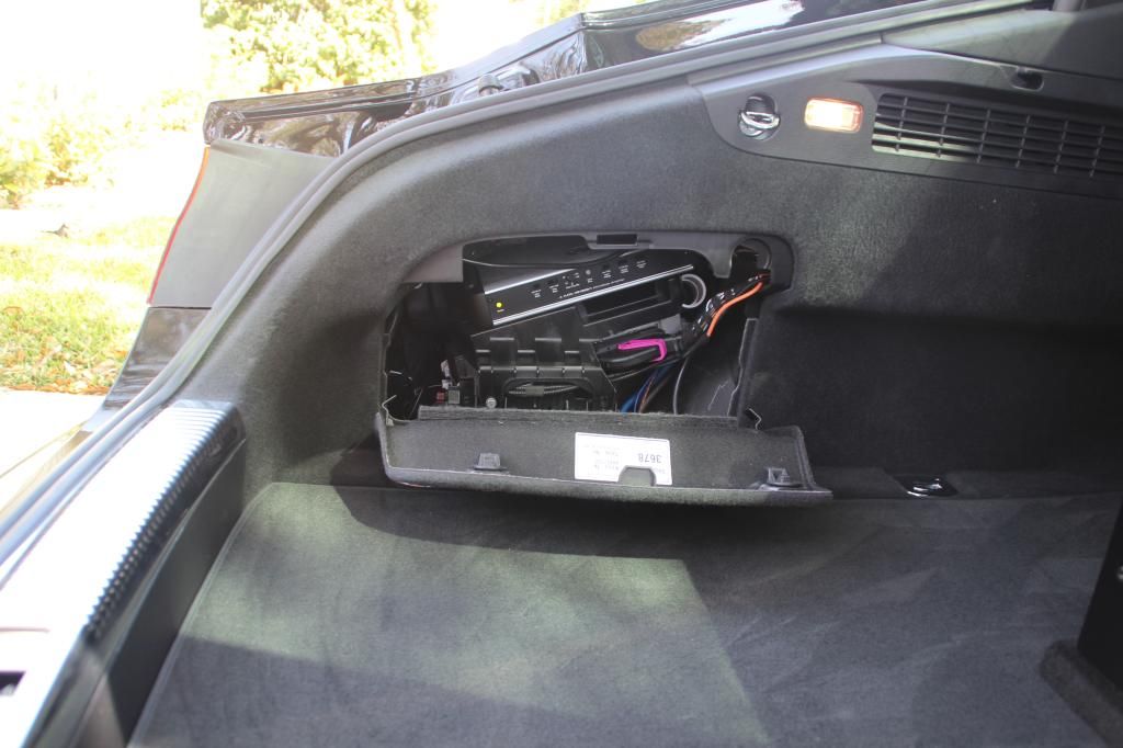

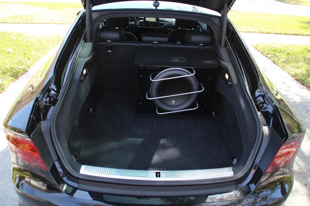

    i attempted upgrading the tweeters in my A7 w/ Bose to JL Audio C5 tweeters. it sounded good, but too bright for me (even though they are silk dome tweeters). I went back to the Bose tweeters as they sounded better matched. Ive also played around with several subwoofer setups, and i think by far the one that sounds best is my current setup. 1 JL 13w7 sealed off of a JL 1200 watt amp. I never turn it all the way up, so a 12w7 would have done the job just fine. once you dial in all the DSP settings, i actually think the bose system with an aftermarket subwoofer sounds pretty good.

    Wow, I don't even want to know how loud that 13w7 can get in an A7 haha, but looks awesome! I have a 10w6 in my S6 and it's more than enough, although, the sound dampening and build quality of our vehicles clearly show here - I have to open up the backseat if I really want to let the sound in. I am happy with the Bose system + aftermarket sub. The low end on the Bose system leaves a lot to be desired though.

    Quote Originally Posted by UFmike316 View Post
    I would be scared to get in that thing with a W7 bumping. That has to be SO loud...

    Quote Originally Posted by jmeenach View Post
    Loudness is not the issue - it has a volume control. The trick is reproducing the original recording and that includes all of the audio spectrum. A booming bass with nothing else is as obnoxious as tweeters that screech in your ears. Once you can reproduce everything correctly then how loud it is becomes an issue determined by the volume control setting. Yes, speakers have to reproduce the amplitude and the amplifier has to put out the necessary power without distortion so the problem becomes the "system". The Bose is a balanced system, unfortunately it consists of numerous components all of average ability.
    My first car was the limited production 1970 Firebird Formula 400 and I had JBL studio monitors held in the back seats with the seatbelts and fed by my AM radio. The sound? The JBL's faithfully reproduced the crap source that was feeding them.
