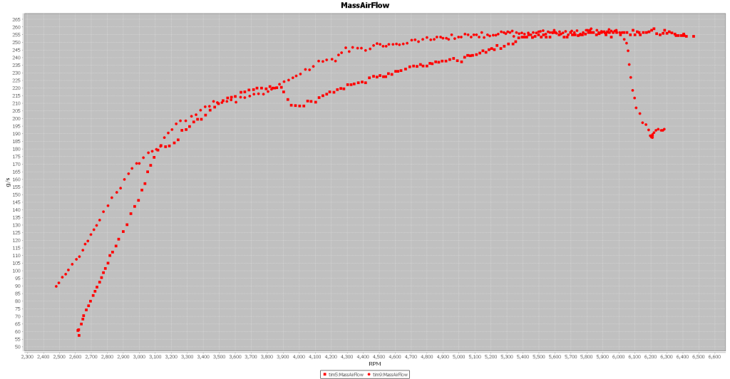

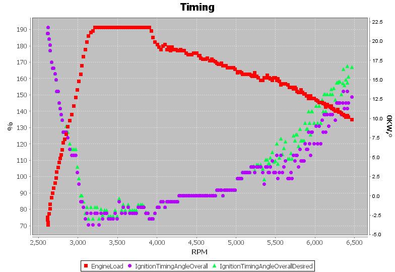

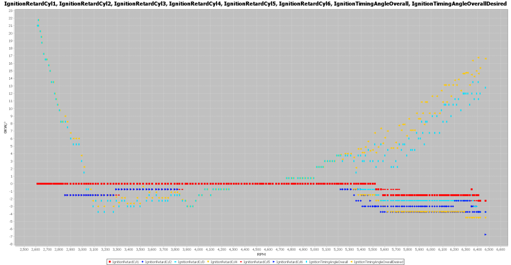

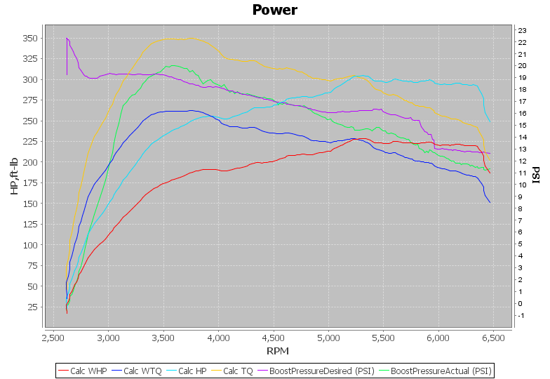

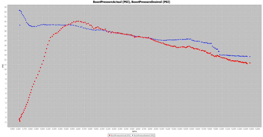

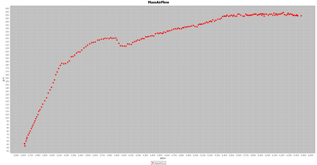

    here are the logs from a normal stg2+ car with just the cams installed . no fine tuning for the cam changover
    From some logs ive been looking at its hitting 220 g/ps about 500rpm sooner then other stg2 k03 cars . Yes the changeover needs to be tuned because these cams are just waking up and then the changeover happens.
    Looks like they work on k03 cars. We did this to really see what they are all about because when i asked about doing them people were asking me why i would put them in . anyways here ya go .
    Ill get a pic of the dyno before and after the cams . done a week apart

    What temps (outside and intake)?

    outside was 75-80 deg didn't log intake air temp or atleast it isnt in the log. only draw back we are seeing is the boost is dropping off at higher rpms. were going to change the boost profile to make sure we can hit requested. hopefully its the cams are drawing more air then the k03's can supply. either that or there is a wastegate/boost leak issue. we smoke tested it and there is a slight mount of smoke coming from the pass side wastegate area.

    you can see the boost log that its a steady decline

    I've got a log of reaching 220 g/s at 3680 rpm and 18 psi, but 50F.

    Here's the log I was referring to and your data. Yours is the higher boost (blue lines).

    I see what you were saying jeff , looks like you built boost way faster also . Ill log intake air temp next time with another revision.

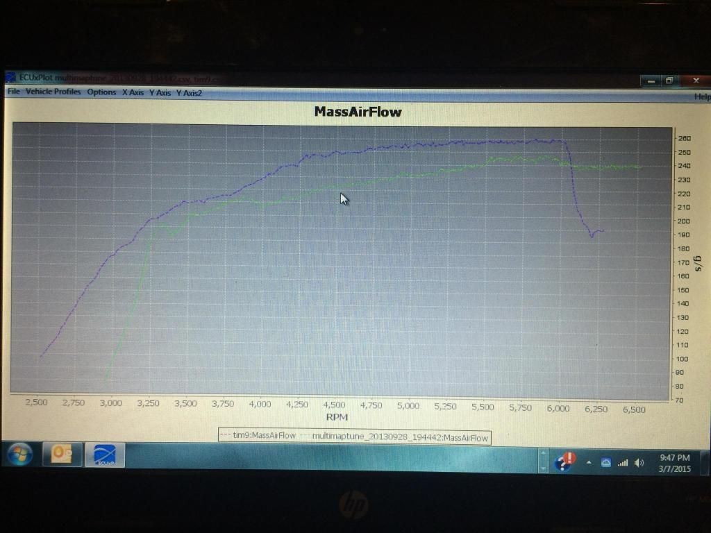

    when compared to another s4 here in az it this is what we get - both cars running the same tune.

    So if I'm reading that last graph correctly, the 2.8 cams not only spool earlier but also hold power at the top end better than stock 2.7 cams?

    yeah , exactly . good upgrade , just make sure you tune for them . you can see the dip at 4k in the green graph on stock 2.7 cams

    Unless you guys are running in the same conditions and plot throttle angle it's really hard to say.

    they are both wot pulls
    the other log is from corradovolksb (brad helping with tuning)

    Maybe I can shed some light.
    All the online write ups on tuning unanimously say that overlap on cams sabotages spool up of turbo but I found the opposite the truth. Disregarding MAF readings (which might be deceptive since most of the gain might be actually due to heightened venting of cylinders, not actually engine using this air for anything tangible), I actually determined that on 2.8 heads there is a big difference in spool up with VVT engaged for a total of (Sic!) 44 degrees of overlap (22 from 2.8 cams and another 22 from tensioners). If left off, that would crudely simulate 2.7 cams with VVT one. It was several hundred RPMs on tial 770s.
    That's a fact.
    If you dyno the car (don't look at MAF!) and determine actual difference with VVT on and off at given RPM threshold of VVT going off (I will tell you right here that you should investigate 5.5k first as that's the break point for VVT), then you can determine where that break over point is.
    Just look at RS4 stock tune and realize that Audi perhaps sabotaged S4 2.7t engine with low switch over point to make RS4 look better....
    Again, MAF is not what you should be looking at since it doesn't tell the full story.

    i provided a dyno shows the gains at the cam change over
