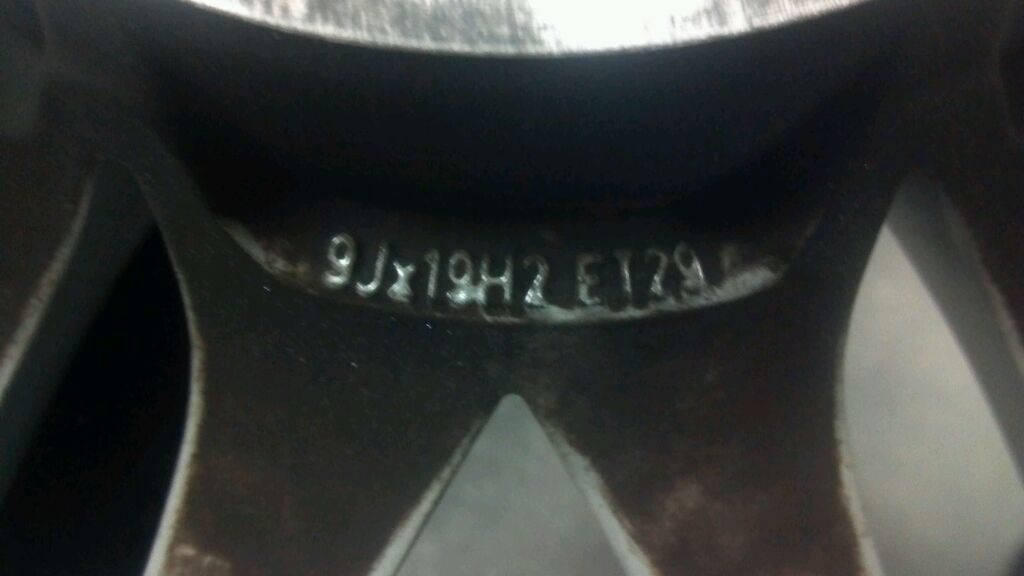

    I've found that the replica wheels rarely have the same offset as the original wheels. There will be many that are 19" and 9" wide, but rarely will they have a 29ET. That was always my first clue that they were replicas.
