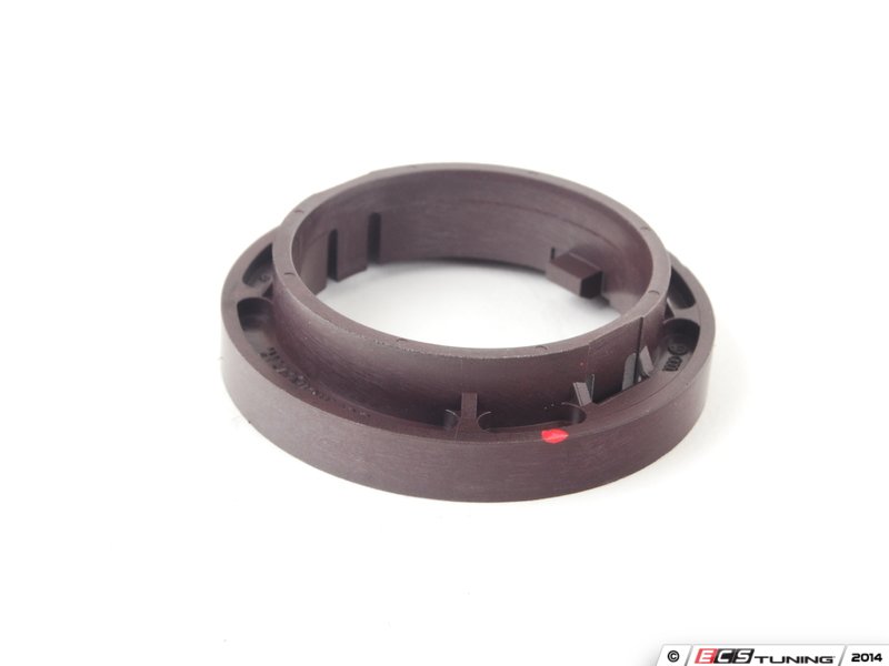

    I have rebuilt my 6speed transmission using the JHM rebuild kit, everything went according to plan. I started to change out the seals on the front diff and must have got a little too aggressive on the drivers side and broke the speedometer sensor ring behind that seal. I have been in touch with JHM for assistance, but I feel they are stumped as well.
    I have scoured google, all the audi forums and have not gotten much. Even an Audi part number would be a huge help. Surely Im not the only one who has broken one of these!!
    It's part "D" in the picture.

    012409187C "Speedometer drive gear", part of 01E409123 "Taper roller bearing"
    http://www.ecstuning.com/ES1912623/
