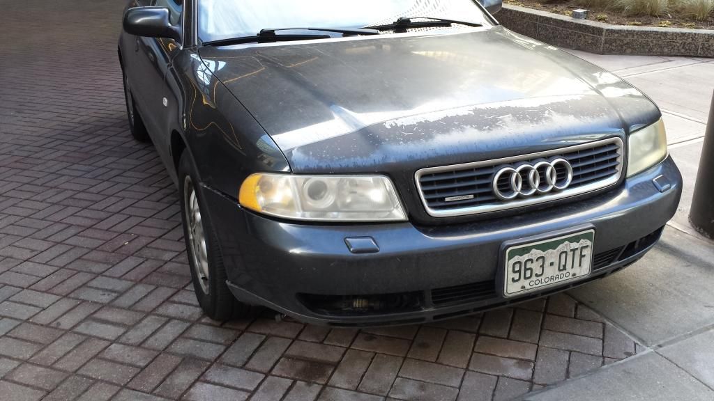

    Hey, welcome to my build thread! Starting off, i have a 1999 A4 2.8 30v Quattro. My goals may be set a little high with this car, but i eventually want to make it a show car. I have a looooong way to go, i know. I bought the car in July of 2014 for 1500$USD, haven't done too much to it, simply due to the fact that I am tight on cash, and don't have a very great place to work on it. I live in an apartment it Denver, Colorado; no garage, just a parking lot. There's no stopping me though!! (Except for the foot of snow on the ground at the moment )
    I plan to do all of the work myself, no, i am not in any way an expert. But i hope to be in the end! I'll show what i have done to it so far, with pics!!
    There she is, no real body damage, just some pretty terribly faded paint!

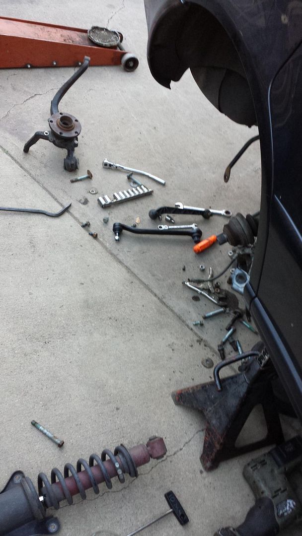

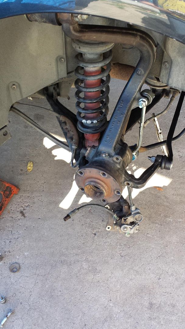

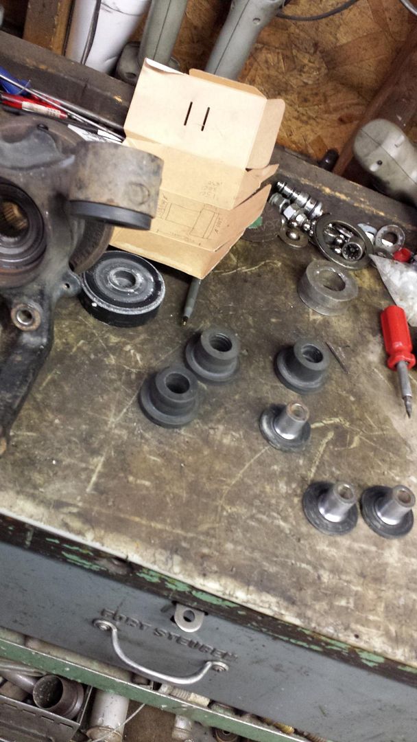

    When i got it, the rear tie rods were bad, when down there i found that the bushings were pretty worn, so i went ahead and did tie rods, bushings, bearings, etc.

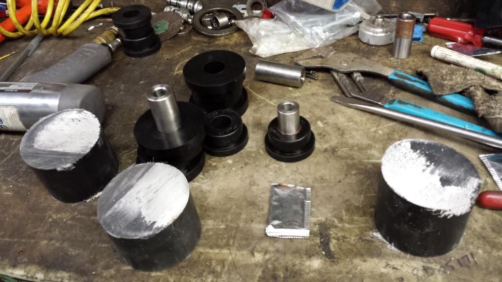

    Had to knock the old bushings out with an air hammer, they were toast, destroyed them on their way out. Hit a snag - the kit i got from ECS was missing one pair of bushings...my cousin is a machinist, he made some bushings to put in out of a bar of polyurethane that he had laying around!
    And then we put it together!
    The bushings made a huge difference in the firmness of the ride.

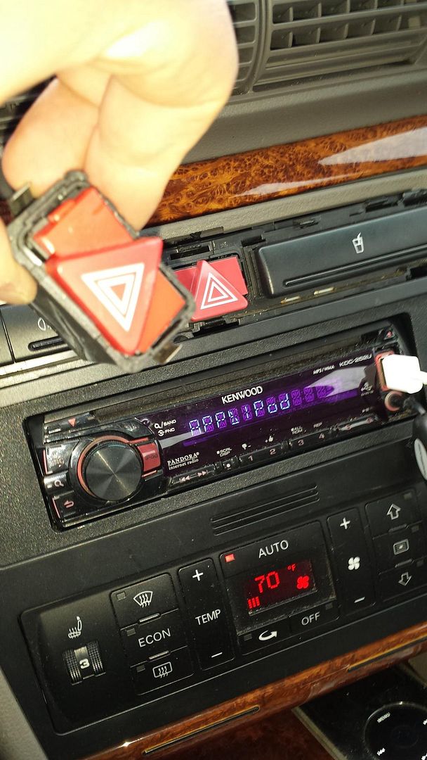

    My turn signal relay went out on me, got that done too!

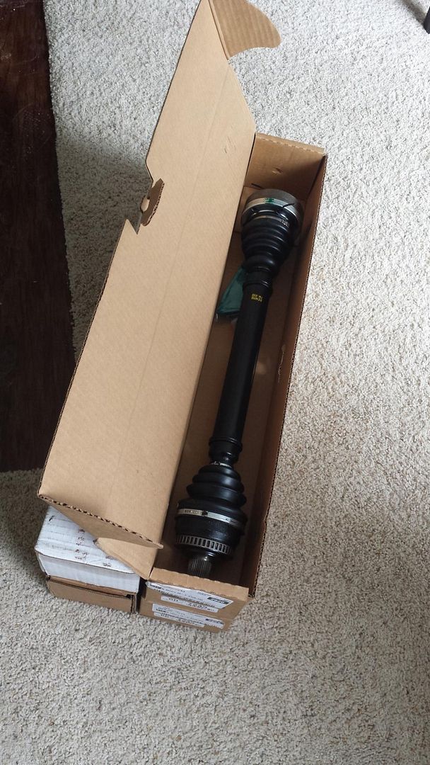

    And finally, I just bought 4 new CVs for it, going to do the CVs and front bushings (poly) as soon as the weather here clears up!
    (bushings on back-order)

    Welcome. What bushings did you use in the rear? Notice any creaking or squeaking?
    Few people run poly bushings in the front. Most just replace the whole arm with a replacement unit. It's usually the ball joints that wear out before the bushings do as well.

    I used Powerflex Black Series, full kit. And they somewhat creak when its really cold out, but i greased the hell out of them so they don't make a sound when it's decently warm. Obviously the old ones were squeaking badly.
    Is there a specific reason people don't do poly in the front? There isn't anything wrong in the front really (aside from CVs), I'm just really big on consistency; having two different kinds of bushings somewhat unnerves me.

    Cause everyone just buys a full Control arm/tie rod end kit.

    Well the kit comes with all new metal so you know you get a perfect allignment.

    Yeah, ate through the tires that were on it when i bought it within 1 week, drove about 100 miles. It was baaaad haha. Oh, also after the job, we found out at the alignment place that the passenger side spindle was bent...went to a pull and save, got a spindle off of a Passat for 10$. Sadly, the ABS sensor for the Passat spindle is slightly different from the a4, so now my ABS won't work. I'd prefer not to have it anyway, but the light on the dash makes me go crazy.

    The other thing to note on the front bushings is that they are REQUIRED to flex for the uprights to be able to turn. If you take off one of the front wheels and have a friend turn the steering wheel, watch how the uprights and control arms move. Making the bushings stiffer will induce binding in the steering.

    Real nice! Need to do bushings on my rear too, but figure I'll just replace everything.
    Curious to know why your cousin simply didn't build you all new bushings. I would think it would have been considerably cheaper

    It's a pretty long process, especially when you want it perfect. Finding the right poly and metal is a pain too. The poly we machined is considerably harder than the poly in the bushings kit for sure.
