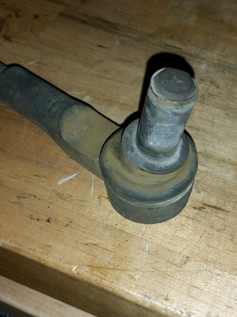

    Thanks guys. Found my passenger side outer tie rod loose/failing at the joint. Somehow missed that last night. Only 15k on it, changed it when I did the steering rack.

    So the boot didn't fail, but the joint was very loose/sloppy. With only 15k on it, should I chalk it up to a bad part, or could this be a sign there's other things wrong? Inner and outer CV boots look good, and I put on new adjustable control arms when I did the coilovers. I didn't take the time to check out the motor mounts though.
