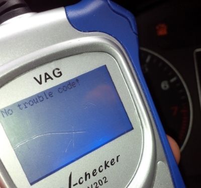

    No, a CEL and with an existing boost code pulled on VCDS. However the vchecker pro said "no fault codes" or something to that extent, I don't remember. I have a documented pic that I took if I can find it. Haven't used it after that obviously.
    Most boost codes are ECU codes so vchecker wont read that. But shouldn't have a problem reading most other CEL codes.

    That scratch is on the protective film I left on. I can assure you this was properly connected when I took the picture.
