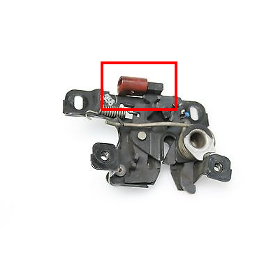

    This is what I'm looking for:
    Also need this:

    It's this part that I'm missing, the connector that plugs into is still there under the cover next to the power steering reservoir.

    yeah that might be it. try taking a piece of wire and stick it into the end of the clip so it makes a loop. then try locking your car
