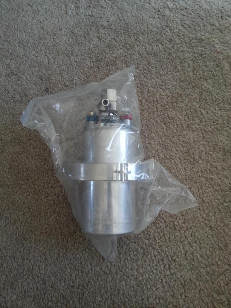

    Bosch 040 drop-in kit from 034 Motorsports

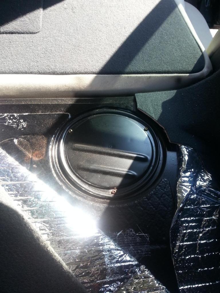

    My fuel pump access plate is in the trunk, just aft of the passenger rear seat. I have heard that FWD, Avants or even 2.8s might be in a different location, like under the rear seat. Remove the 3 screws of the access plate and remove the cover.
    STOP HERE! see how dirty the fuel tank access is? You DO NOT want this crap in your tank, spend the 15 minutes it takes to clean this; I used a vacuum, paper towels and carb cleaner.

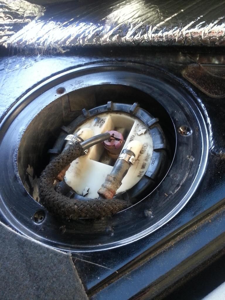

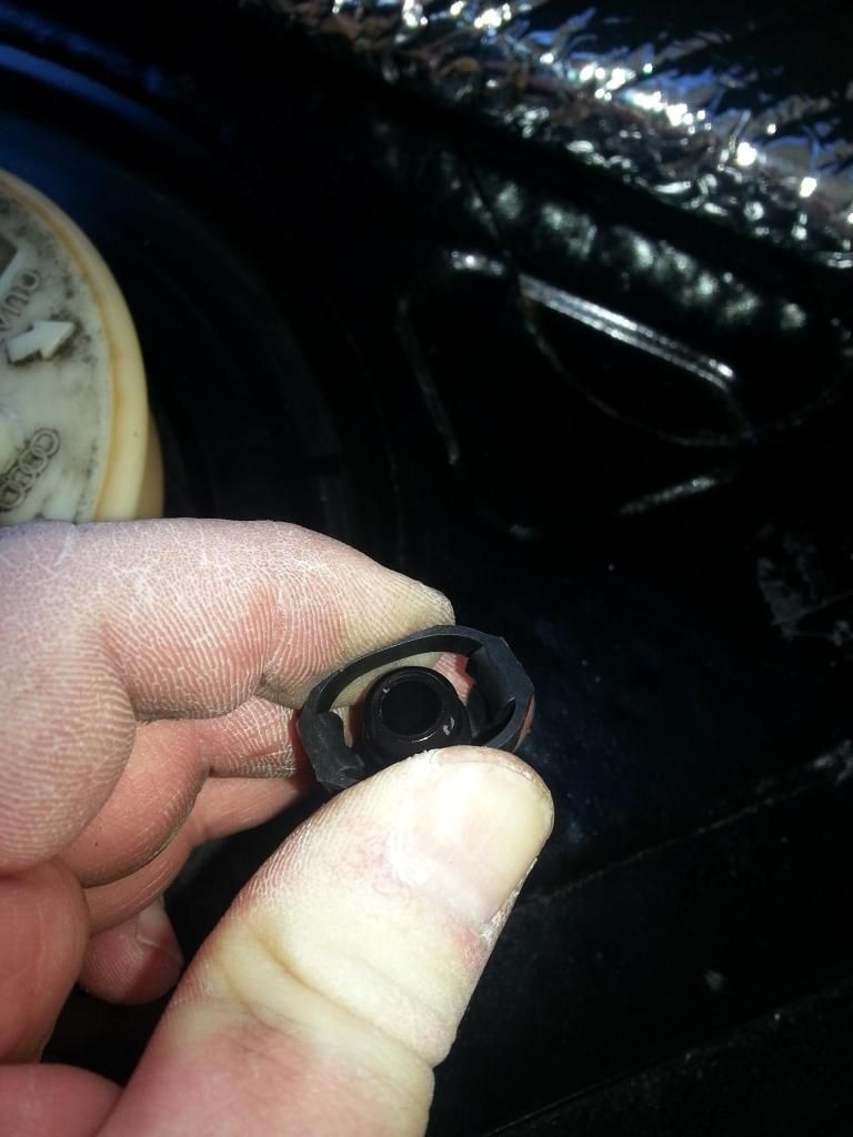

    Remove the fuel lines first, have some towels ready, there could still be fuel in the lines. If this is the first time these have been removed then you will need to replace the one-time clamps with a worm type clamp. My fuel return line had blue ink and the supply line had white ink.

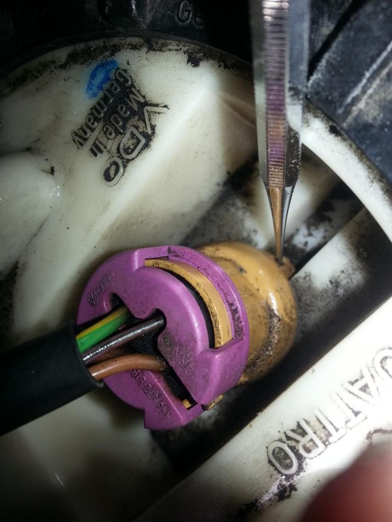

    Now the electrical connector is an absolute PITA, I had dentistry picks that I was able to get under the clips, I undid one side, then kept the connector tilted while I undid the second clip.

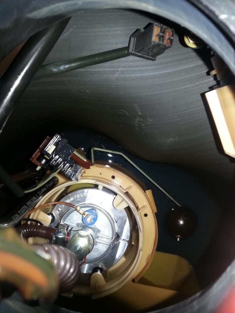

    Pull the flange up and remove the tank level sending unit connector (take a picture of how this is connected, it can be connected in either direction and I'm not sure what will have if you get it reversed). Remove the full return hose, this is a little tricky, you have to squeeze the connector ring to remove it.
    Be careful not to ruin the rubber gasket for the flange, I removed mine so I didn't damage it.
    You can set this flange or cap aside (it will be in your way, I'm not sure if completely disconnection it would help because it will be a PITA to re-install it with the pump in the tank). Audi makes a tool to remove the basket, but I was able to reach in and turn the old pump which also rotated the basket. Before you start, mark the direction of the basket (take a picture) this basket only goes in one way. You need to rotate the basket 15 degrees counter clockwise to remove it.

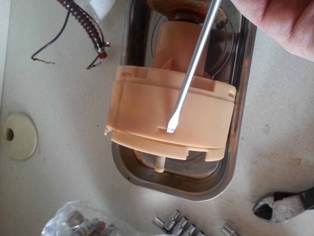

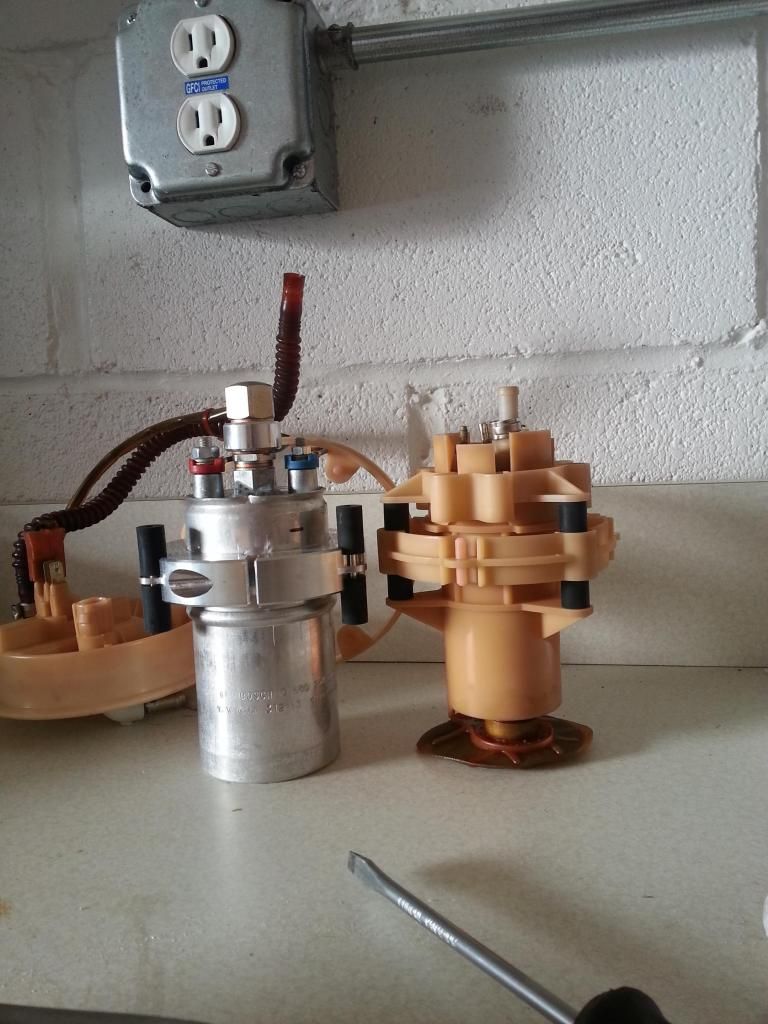

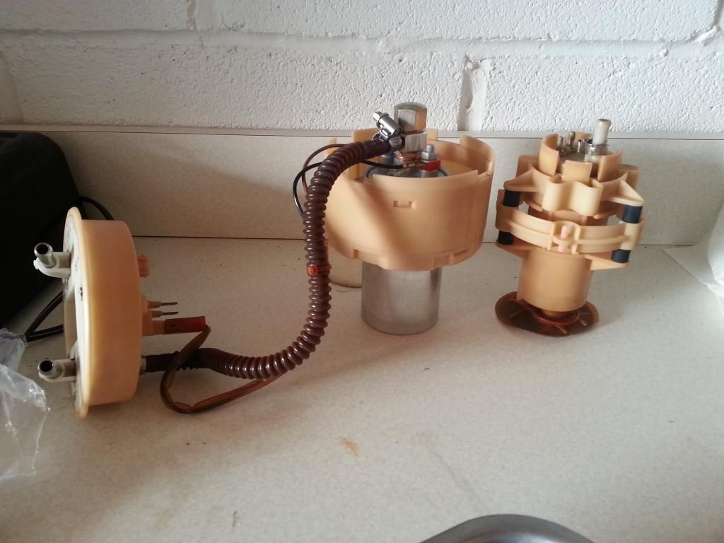

    Once you have the basket out of the car, take it to a clean work area for the swapping of the basket to the Bosch 040 fuel pump. You need a 7mm and 8mm socket to remove the wiring from the old pump, or you could just cut the wires after the connector (pay attention to which wire is positive and which is negative). Remove the one-time use clamp on the fuel line and pull off the line. You are now ready to remove the basket. Pry the clips from around the basket and remove the top from the bottom.
    Adjust the ring on the 040 to the same height as the old pump you'll need a 4mm allen key. I chose to lower the ring an 1/8 of an inch, this will cause you to not have as much usable fuel in your tank, but will also lessen the possibility of sucking up sediment from the bottom of the tank.

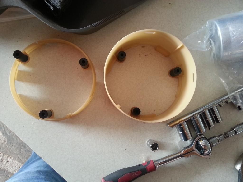

    Swap over the rubber mounts for the basket and install the new pump into the basket, it will only go together one way. At this point if you purchased a new piece of fuel line, install that now, otherwise reconnect the fuel line with a new worm clamp. Cut off the wire connectors if you haven't done so yet, strip the wires and install the new ring terminals supplied in the kit. The black wire on my old pump was positive and the brown wire was negative. You will need an 8mm and a 10mm socket to tighten the electrical connections (don't torque these down, it's aluminum, you can strip the threads; just until it's tight).
