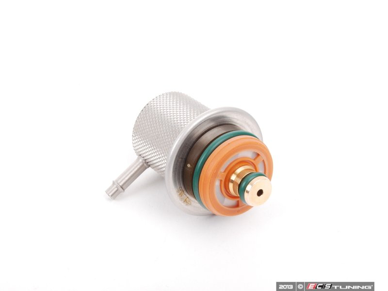

    HEre is stock like adjustable FPR with small orifice so no improvement over stock situation:
    Here is adjustable FPR with big orifice (so no pegging at FPR but stock fuel return lines might still be pegged by high flow pump):
