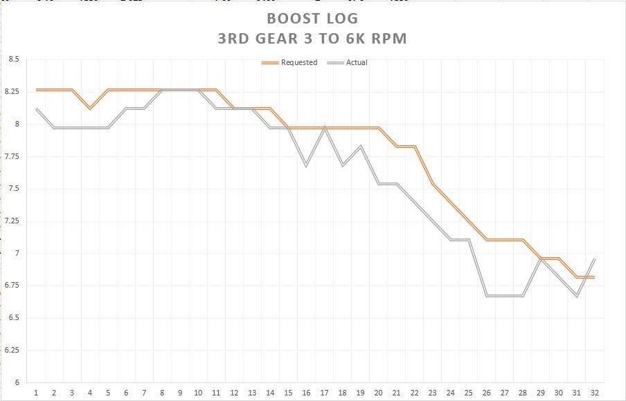

    So after installing a new 034 breather and a new set of injector seats, I had the puter plugged in to clear all the misfire codes from when the stock breather turned to dust. I figured, hey, the snow is off my road, lets do a third gear pull and log it.
    So I logged measuring block 115, started at 3000 RPM, stopped at 6000 RPM, took those numbers in Excel, subtracted 1000 for atmospheric pressure and multiplied by .0145 to convert to PSI. This is what I got...
    So, what does it mean? She's stock with 130K miles, but damn. less than 8.5 PSI? Is this normal?

    I'd say that's probably normal for a stock tune. You could always measure requested boost vs. actual boost. If there is a huge difference, you have a leak somewhere, but I doubt that's the case.

    Orange line is requested boost, grey is actual.

    10 to 11 psig is the stock boost specification.
    Make sure the conversion from millibars absolute pressure to "pounds force/inch^2" gauge pressure, psig, is correctly calculated.

    If 10 or 11 is available, why is the ECU not asking for it?
    Air temperature affects in air density. Obviously colder air is denser than warmer air. What you will find is that your maximum boost pressures will drop in the colder temperatures. Mine typically drops 2-3 psi between summer and winter.
