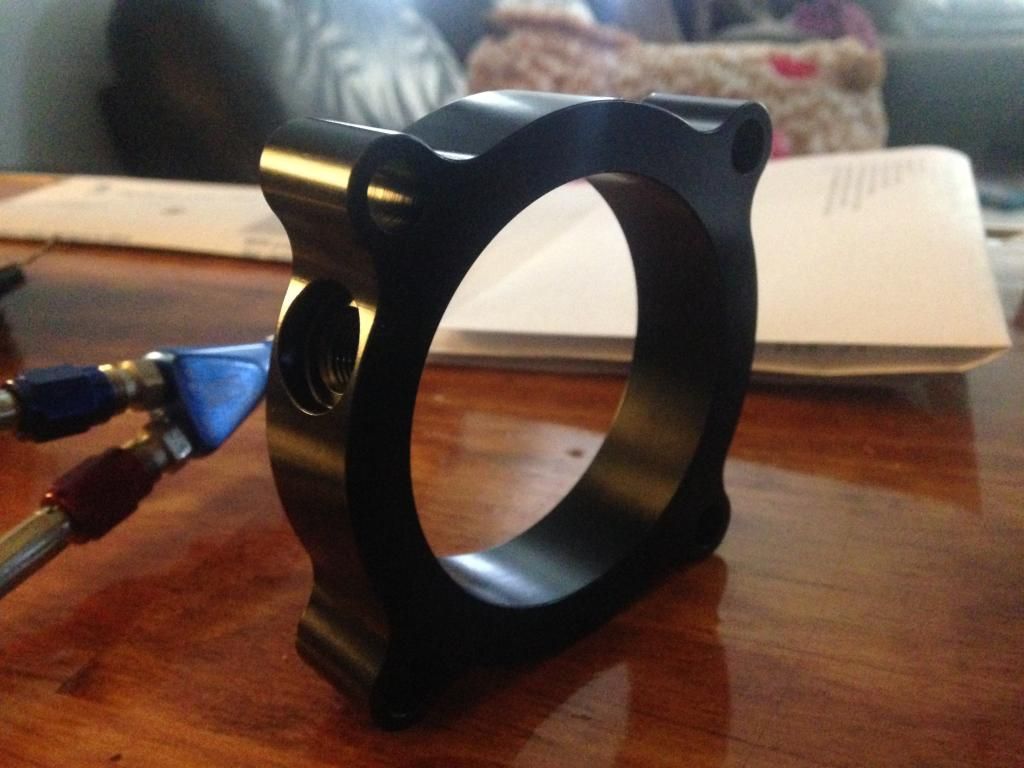

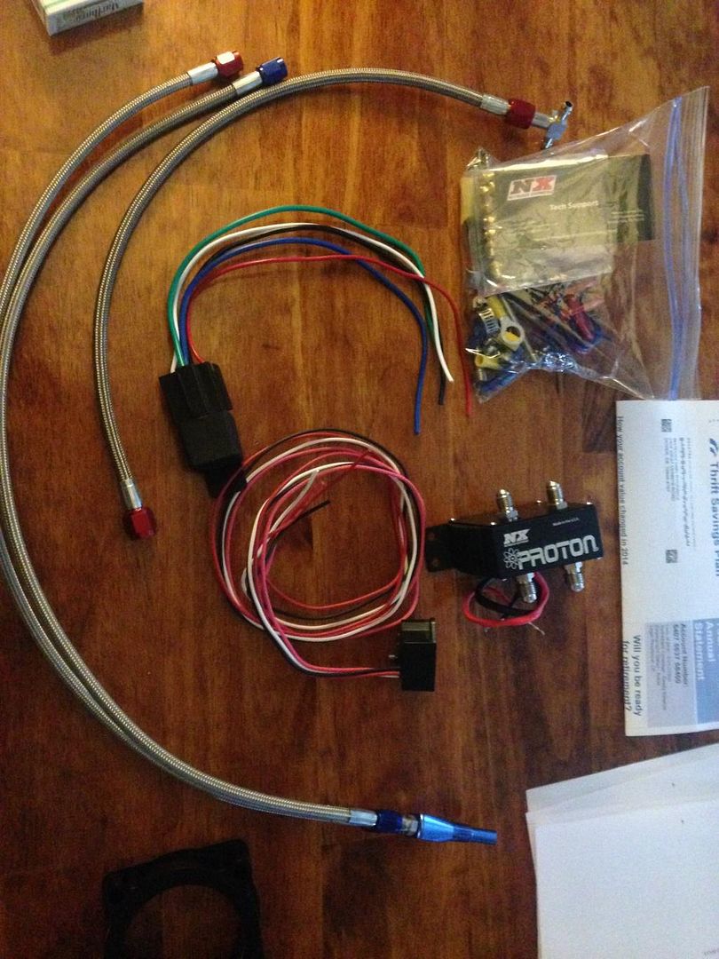

    US Rally Team Meth injection plate... that the nitrous nozzle fits into perfectly
    part of the kit

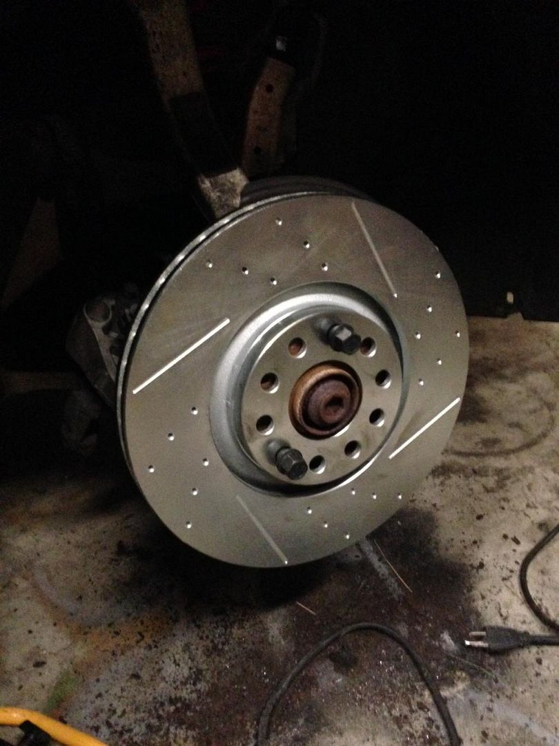

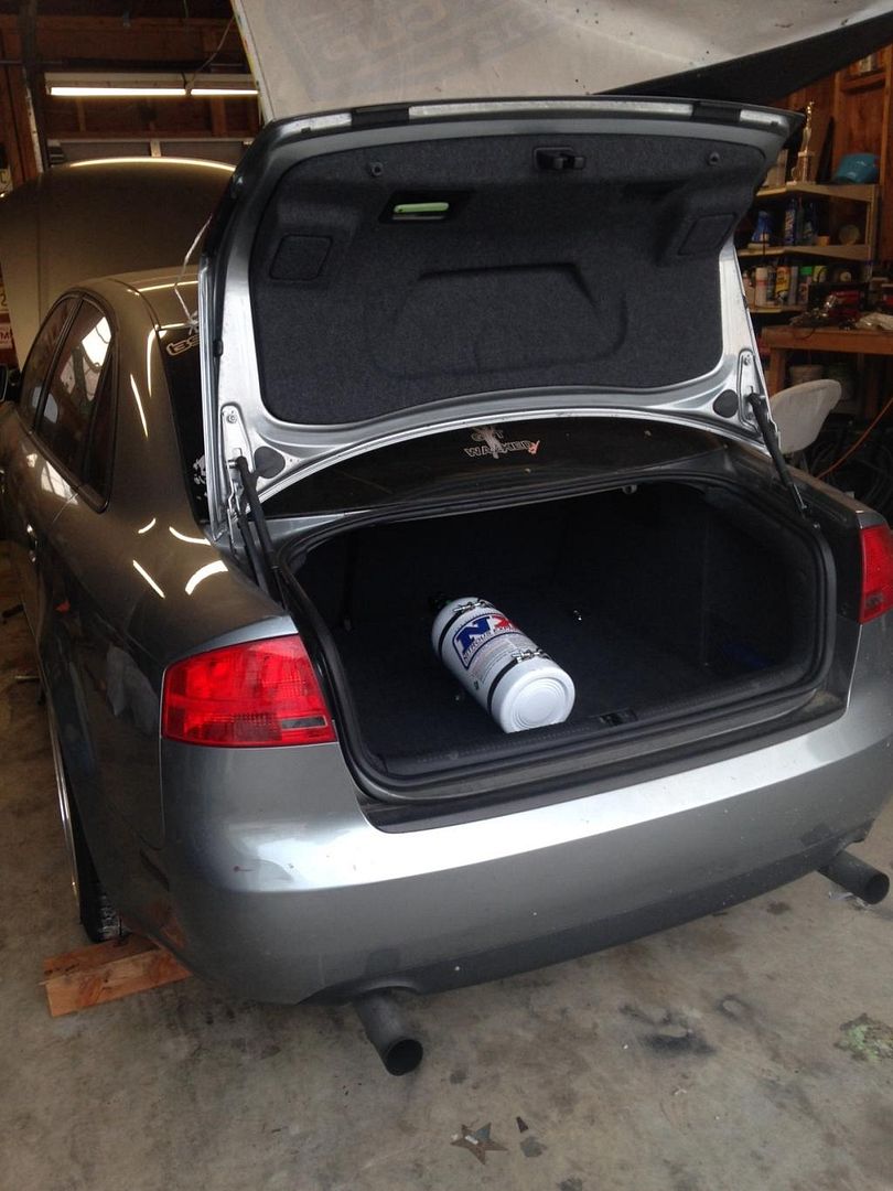

    bottle mounted
    also some upgraded stopping power

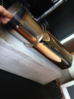

    Jun 27 2011
    77478
    Duuuuuude. your exhaust tips......
    are temporary

    I wonder if using that plate would allow to the fuel to puddle in the piping? Do you plan on upgrading the LPFP, or just seeing how it performs?

    How big are the exhaust tips?

    Those don't strike me as any better but its your car.
