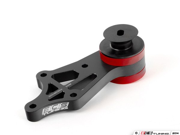

    Ok, so I'm going back to the stock mount with a SPR, and I'm thinking to fill the voids with window weld as people have done in the past. I also have a sheet of 1/8" neoprene bearing pad that I might see if I can slide in there to help reduce NVH, but I'm guessing there won't be room. The car mostly sees track duty, but I do daily it from time to time and I don't want it to be too obnoxious...
    These poly mounts are a great idea and all, but I think high-density rubber is a better way to go. More durable and less susceptible to chemical deterioration. With all the mounts that 034 makes for this car, it's a shame they don't do this one!

    Quote Originally Posted by BITRBO View Post
    FYi that makes a LOT of NVH... just ask Monty23. Window weld is awesome but stiff as fuck.
    I can ship you my window welded mount if you want it. I'm never going to use it since if made too much noise.

    I had a power ring that I just replaced with a ECS mount shown above. Honestly the Power ring wasnt too bad with NVH.. I am really liking the ECS mount. With that being said ill sell you my Stern power ring for like $40 shipped to your door.. PM me

    How's the NVH comparison between the ring and ECS mount?
    ECS, what is the durometer of your poly bush?

    Our poly blend is 70A for a firm yet compliant feel.
