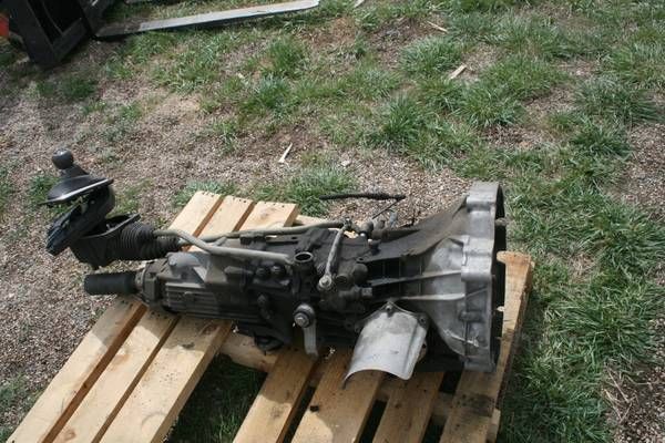

    Now its looking like maybe i should sell the current 01E and get one from the A6/S4 2.7

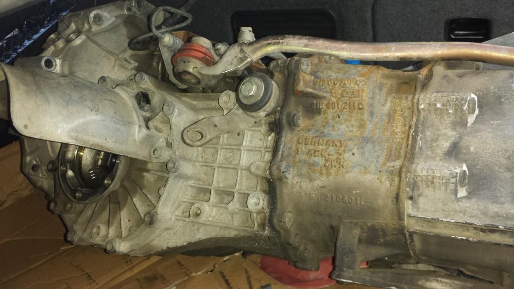

    You need the matching rear diff- normal 4.2 cars have 3.70 final drive, S6 / A6 /B5 S4 manual 01E trans in USA is 4.11 .
    And that trans you have pictured up there looks like an 01E, but ...it has what looks like might a B6/B7 A4 shifter?

    YES. If you get one of those you can leave your existing 4.2 rear diff also.
    It is an 01E. and the guy said it was from an Allroad. is there anyway i can tell for certain what Gen and what it came out of?

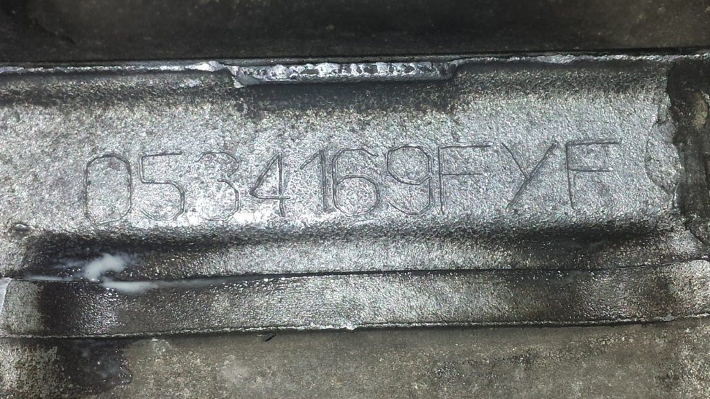

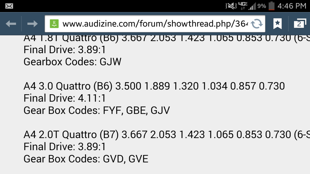

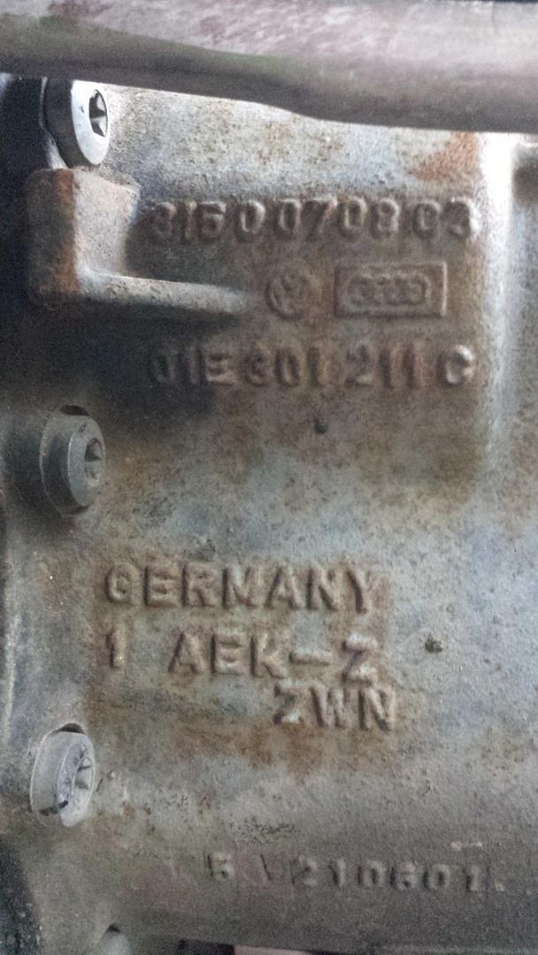

    Look on the bottom/ sides up near the bellhousing for the trans "code" ; it'll be 3 letters like "EDU" . Then read through this thread for more info on stuff about the swap:
    http://www.audizine.com/forum/showth...p-parts-thread
    Also...not sure about your choice for a flywheel? 2.8L "AAN" flywheel . Never heard of anyone in the U.S. using one on a 4.2. I'm sure there are a few flywheels that would work, but if you want to avoid weird issues you might consider doing what's known to work- either an aftermarket unit (single mass/ lighter) or an OEM 2.7L dual mass.
    Maybe the AAN flywheel works? If it does indeed bolt on What I would worry about is if any decent clutch/ pressure plate would work- meaning hold 4.2L power.

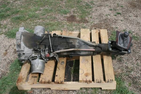

    From OP's picture, it is NOT an Allroad 01E, Allroad 01E has different front output flanges, and has oil cooler lines from the driver side. This maybe a normal A6 01E. I am local to you if you need help determine, PM me if you want. Good luck
    Sep 11 2009
    47633
    NE
    Quote Originally Posted by chinaren View Post
    I attest to this, this one doesn't have cooler lines which are standard on all allroad trannies. OP, check the tranny code.
    Quote Originally Posted by julex View Post

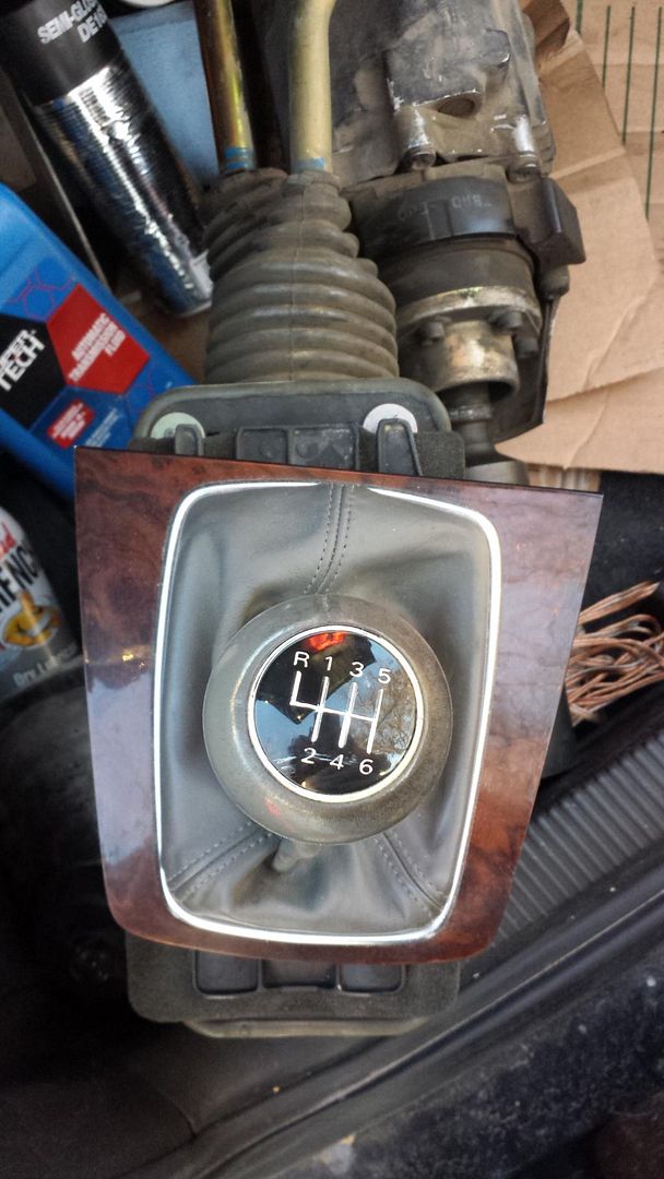

    Alright. I will check monday. its in the trunk of the A6 at school. The bezel though doesnt resemble an A6 though. more like the Allroad trapeszoid. The guy i bought it from said he pulled it from his allroad.
    EDIT: actually as i research more. the bezel looks like an S4 bezel.
    "Bezel" what are you talking about?

    That shifter and trim is from a B6/B7 A4. Could just be something tossed on there for some reason. But, for sure check trans code- don't go shopping for more stuff until you know for sure what you have.

    Sooo. with the research i've i may have hit the Jackpot. the trans code is AEK. and so i'm pretty sure i have a TDI Trans. :D
    Heres a better pic of the shifter and bezel if that helps confirm the model trans

    That definitely looks like a b6/b7 shifter. Not sure what bearing that has.

    Veteran Member Four Rings rollerton's Avatar
    Sep 16 2010
    64156
    Central Wash
    You want to look down on the bottom; like this:

    Quote Originally Posted by rollerton View Post
    cool. thanks Rollerton. I thought i was looking more for a plate on there like the autos. so when i saw everything on the sides thats what i assumed was needed. I'll check the bottom today.
    You were right :)
    Right again about it not being an allroad.
    Finally did
    So went back and checked on the bottom of the gear box and found the REAL trans code.
    So it turns out it is in fact a B6 A4 3.0 01E. Great news is, the final drive is 4.11/1 I noticed the gear ratios are very similar to the allroad but will the 4.11 diff make the difference and give me decent highway mileage. I know others have said with the ALLROAD trans they will be running like 3600RPM going 80 in 6th. Here are the gear ratios for the B6 01E that i have.
    So i will most likely be keeping this trans and getting the rest of the kit together.
    Sep 16 2010
    64156
    Central Wash
    Quote Originally Posted by darknight01 View Post
    I thought that linkage looked kinda short.
    Good news / bad news.
    Now, I've read the 01e B6 / A4 threads where people wanna swap this and that- your problem is now (as far as I know) that the trans isn't physically compatible with the C5 chassis as-is. You will have to do some research to find the specifics- but as far as I know nobody has installed a B6 trans in a C5. Details start with the B6 using ABS for vehicle speed instead of the sensor on the axle flange a C5 uses. Supposedly the trans mount brackets aren't in the same place either.
    I dunno...do some looking ...C5/B5 01E trans into the B6/A4 has been talked about a bunch in the B6 forum.
    i Searched and others are chiming in that the 01E is pretty similar across the board on the exterior minus flanges, internals, and a few other small things. So there is bosch sensor on the bell housing. i need to get the part number and find out out what it is.
    I will also be checking the measurements of the output flanges on Monday.
    FYF would say that it is a B6 trans but it doesnt have B6 output flanges Scotty mentioned. so this trans is just a massive mystery.
